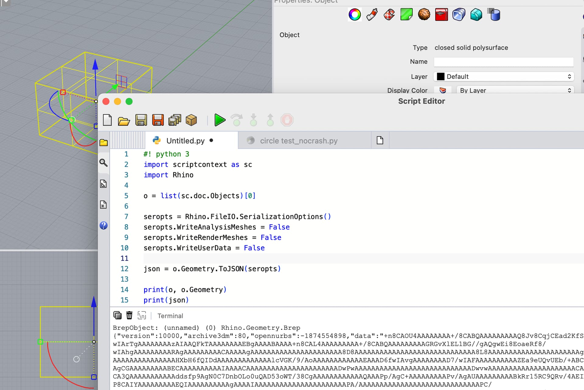

I serialized mesh.toJSON and brep.toJSON, and stored them in one list.
Now I would like to deserialize them. But you need to call Brep.fromJSON and Mesh.FromJSON explicitly.
AFAIK GeometryBase.FromJSON(json) static method can deserialize the json and create the object back for you.
Thank you. How to cast GeometryBase to Mesh?
Python upcasts automatically, interesting.
