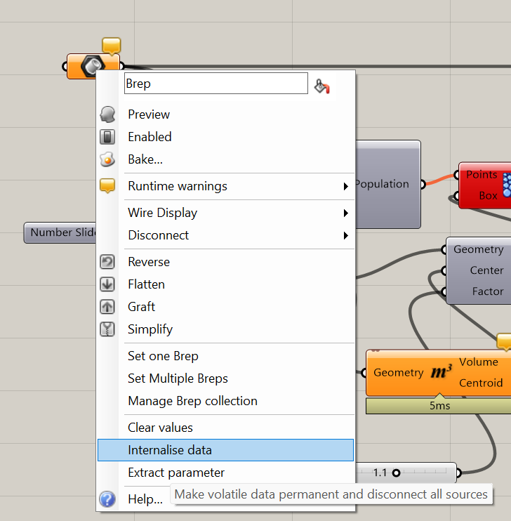

In order for us to help you, you need to share a file with us that has your Rhino geometries “internalized” in your Grasshopper file. This is best practice when sharing files when attempting to receive help from the community, who does not have access to your Rhino file.
You can do this as @martinsiegrist has shown, by right-clicking your Brep or other components and selecting ‘Internalise data’…
… otherwise we have no way of seeing your referenced geometry.
