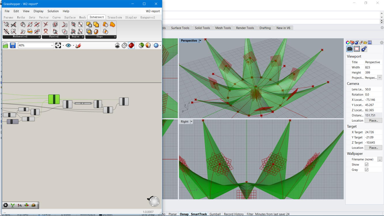

Split Surface with multiple planes or curves

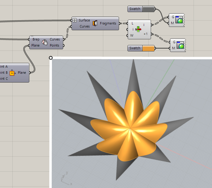

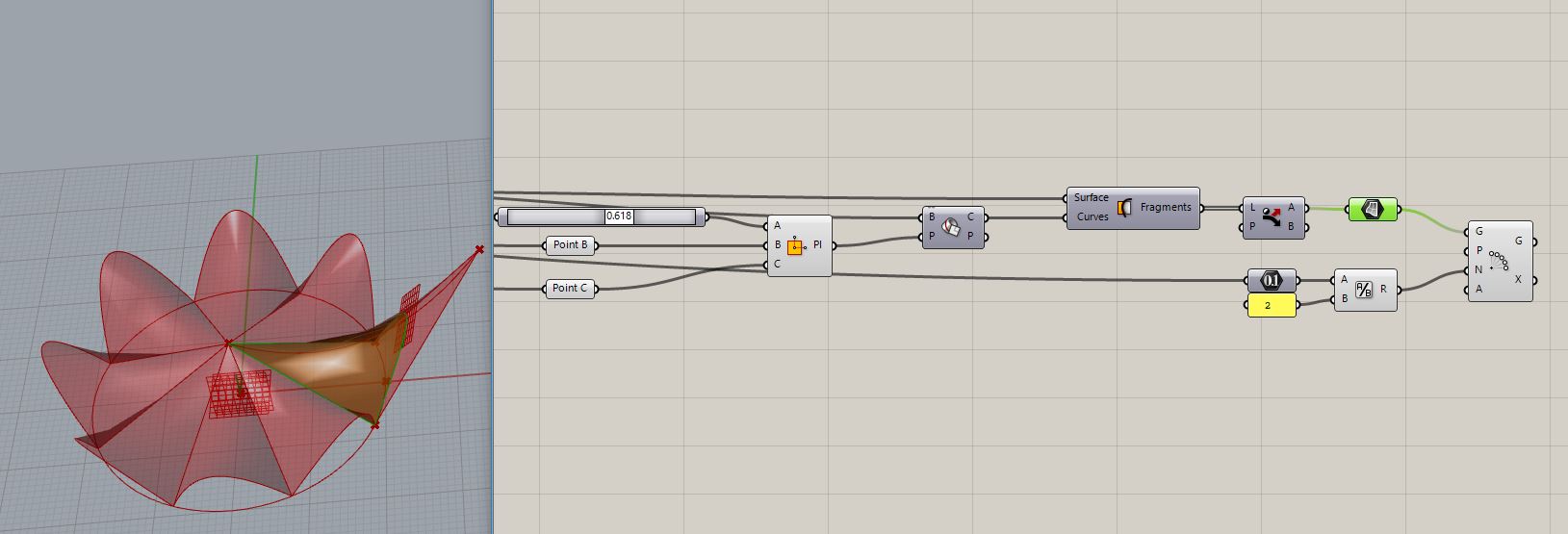

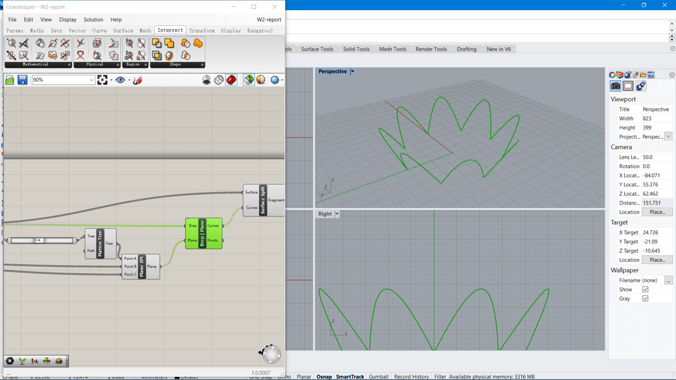

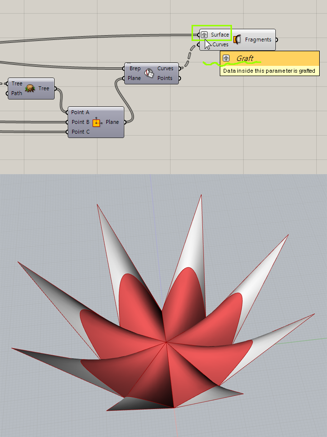

Hi, I am trying to split the whole surface with the planes or curves in each section of this building. But I am not sure which part of my script is wrong.W2-report.gh (13.0 KB)
Hi dowazura. Thank you for your reply. I have did what your photo showed but didnt recieve the same result. May I have your file if you do not mind. Thank you very much.
Thank u very much. I just came up with the things I want with ur help. Thank u very much.

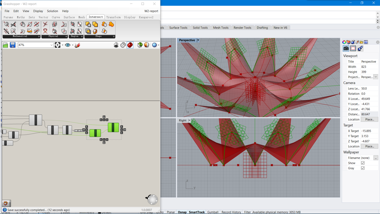

W2-report.gh (17.3 KB)
you can also create one surface and use polar array
W2-2.gh (23.9 KB)
Relly helpful. Than u so much

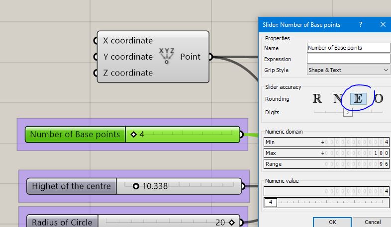

note : you need to change rounding in “Number of Base points” to even numbers
Thank u very much for your reply. Really Helpled!
