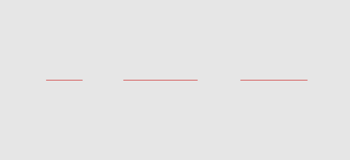

I want to use the blue curves here to split the red curve, and then remove the cut parts so it will look like this:
here’s what I’m doing at the moment (which feels like lots of work for such a simple operation)
so I’m able to cull the cut parts, but what I get right now with this component is only the cut parts:
would like to reverse the last component so I can bake only the parts I want to keep, which will be these curves:
how can I do this?

You can get both for the price of a single component !
(you could also right clic > Invert your Pattern input)
