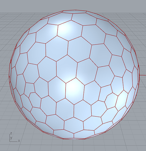

Is there any grasshopper add-on that could help to have a hexagonal subdivision on a sphere.
The image below has 5-side polygon at singularities. I tried smoothing isosahedron from weaverbird, but it does create smooth sphere.
I could be wrong but is it possible that it is impossible to have just hexagon on a sphere.

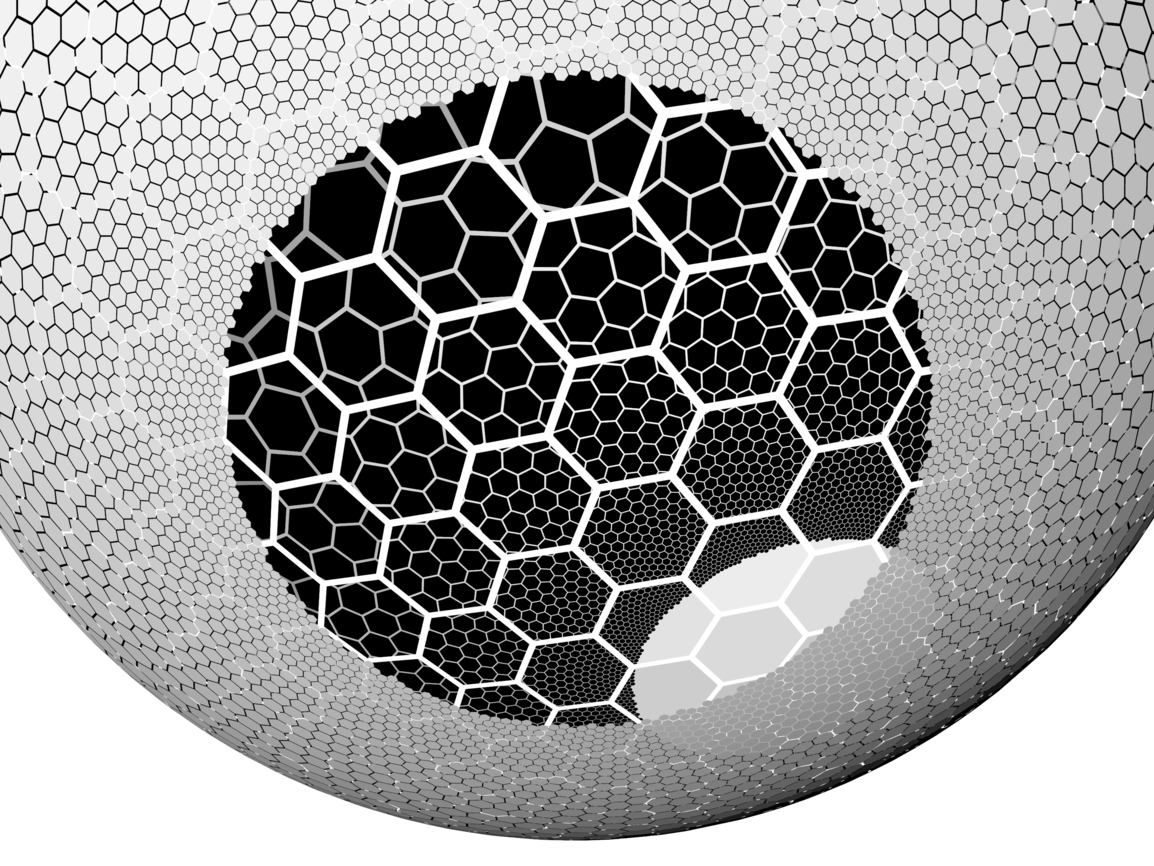

A solution could be to “pack” all the singularities on a small area of the sphere, leaving the rest with only hexagons… but it would be un-evenly sized hexagons, with the largest on the opposite side of the singularities.
There’s a nice interactive model of a hexagonal tiling of the sphere here:
http://pub.ist.ac.at/~edels/hexasphere/

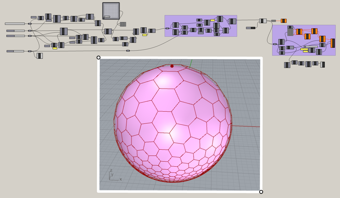

So i switched to pure math:
( I also found interesting this: https://math.stackexchange.com/questions/2121175/is-it-possible-to-have-a-spherical-object-with-only-hexagonal-faces )
And so…
066fb3ee131beb9aed6088300e75b326
Stereographic_projection.gh (27.4 KB)
As expected, with the camera at the correct position, the hexagons look completely “flat”:
Interesting and unexpected (for me) thing: the hexagons are ALWAYS flat!
In the definition there is the control to chose where to put the “first” hexagon: centered, mid-edge or vertex… but the faces are always flat regardless of the starting position!

The hexagons are always flat because Möbius transformations (which inversions are) preserve circles. Since the initial regular hexagons have all their vertices lying on a circle, so do the transformed ones, therefore they are planar.
