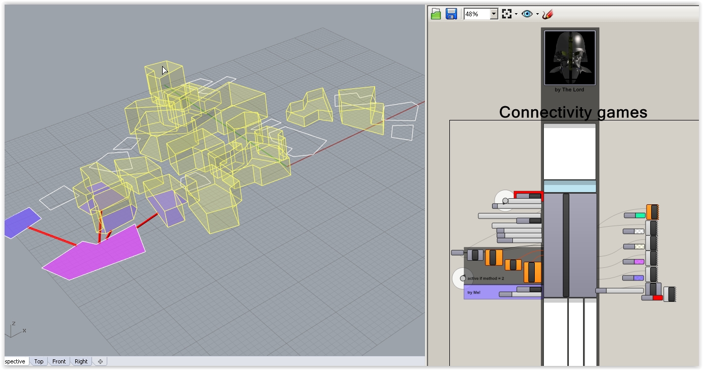

I have a feeling that connectivity trees are a bad thing for you. Here’s Part 1 of a solution using native components and no mysterious C# and other freaky stuff. Requires an understatement of these @%@% trees … thus study the attached and have faith (for Part 2,3,…).
Curves_ProxConnections_V1.gh (36.1 KB)
In fact this approach (using a “delegate” so to speak for the curves [ the centers]) is not 100% correct since actually we should search for prox curves instead of performing prox search on centers … but that’s not the point at this Part 1 phase.
Anyway a hint on that matter: See this:
Whilst results are 100% in order with what we instructed the Prox thingy to do … in fact we actually want to search for curves that have a min/max distance from the red one … a fact that excludes some from the equation (most notably the up right and the left middle one).

And this … er … is Part 2. All the stuff found in Part 1 is deactivated and despite promises code is used for finding prox curves within miin/max distances (see 2 for that).
Curves_ProxConnections_V2.gh (85.2 KB)
  1. Study the results (and the synchronous sort), what they mean and … hmm … the unavoidable curve to curve connectivity tree (that differs from the Point to Point “equivalent” tree derived from the native GH prox thingy [that uses a very fast special collection named Point3dList, but anyway]).
  2. Problem is that this is considerably slower (for good reason) meaning that in real-life (big or very big N of curves,llike in your case) some sort of // processing is required … meaning code. Note the // part is not (yet) implemented.
And this is Part 3: a hybrid approach using the speed of the Prox GH native thingy in order to locate a bunch of “candidate” prox curves and then it process only these in order to get the ones satisfying the min max criteria. It does that because the curve indices and their centers indices match 1:1 so the connectivity returned via the Prox actually is the Curves connectivity as well.

And this is the final thing:
Curves_ProxConnections_V3A.gh (60.0 KB)
  1. We have curves that are building footprints
  2. We get the centers of 1.
  3. We make randomly extruded buildings out of 1 (or we have real buildings on hand and get their ground base face as the footprint curve).
Insofar the 3 as above lists match 1:1. Any given index targets footprint/center/building
  1. We use the Prox on centers in order to make a sort of cluster analysis on footprints . The result is not what we finally/actually want but we don’t care.
  2. For a given curve we search all neighbors (due to 4) for curves that satisfy the final min/max filter. We do that for all curves
  3. We sort the result and find the min max.
  4. We cull buildings by using another (or the same) “more refined” min/max condition.
Why ignoring the GH native component that finds just one prox curve? Well … in order to avoid the Abu Dhabi nightmare: a single closest curve means nothing … the density means everything [see Dubai as well]).
