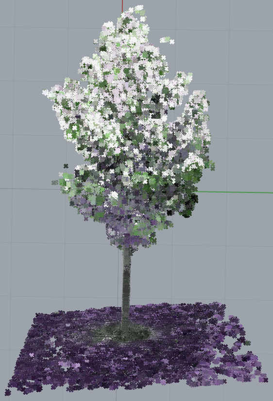

Here is the original tree:
Here is the tree using 25 values each for RGB:
And here is tree using only red, green and blue: (harsh!)

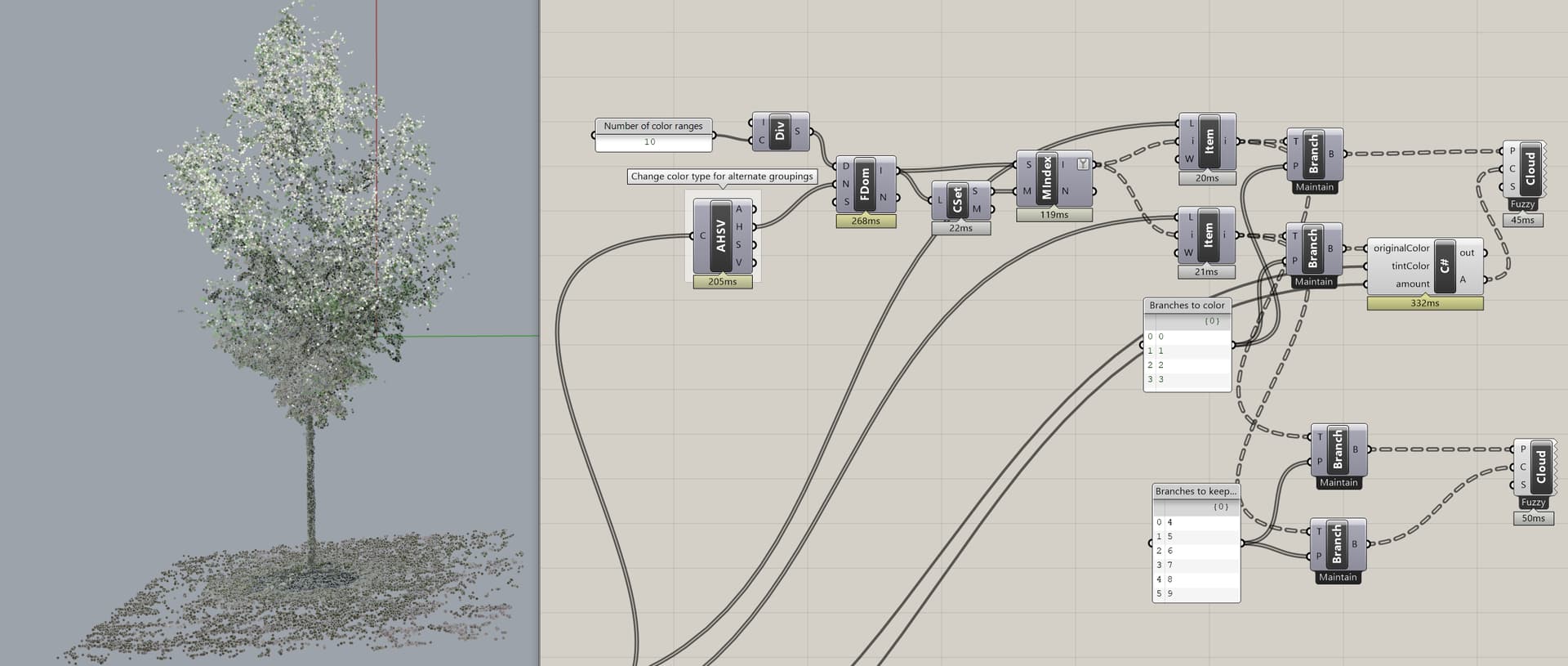

Hi @TTS
When using Volvox, you can import a smaller subset of the point cloud to make working with the cloud faster until you need all the points. Volvox also lets you extract the colors by deconstructing the cloud with DeCloud component. Once you have the colors, you can tint them all at once (C# component uses GH_GraphicsUtil.BlendColour).
20221022_PointCloudColorGrouping.gh (21.7 KB)
Or you can tint only specified ranges of colors.

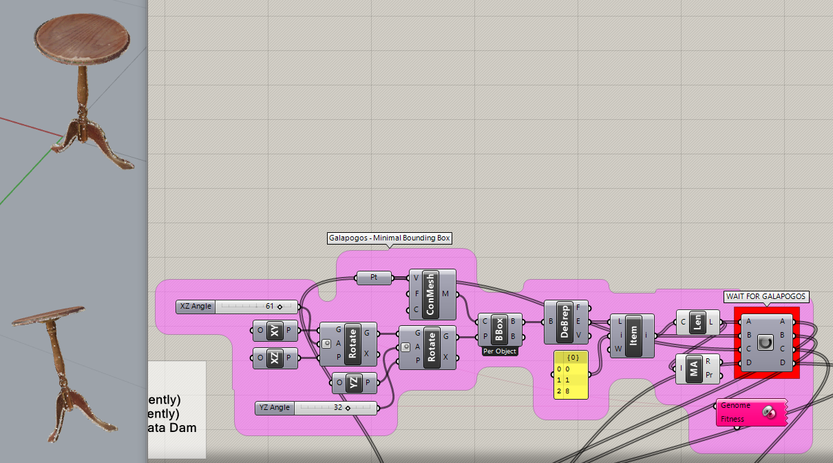

This version has cosmetic changes that don’t address your primary goals (above) but might be general purpose enough to be useful for other GH projects.
  1. The pink group at the top-right uses Galapogos to find a minimum bounding box for the point cloud. When the solver is done, click the Data Dam to pass the results downstream. As always, Data Dam leaks on startup, meaning it passes data without being clicked. :frowning:
  2. The teal-colored group below it uses the minimal bounding box to orient the point cloud vertically at the origin.
  3. Fixed the color issue in the disabled white group. No need to manually reconnect color swatches.
INSTRUCTIONS
  1. Select Point Cloud (then wait patiently)
  2. Start Galapogas Solver (wait patiently)
  3. When Galapogos is done, click Data Dam
    (again, wait patiently)
getPtCloud takes ~18 seconds for both the table and the tree, according to the profiler.
FDom (Find Domain) in the yellow group takes 1.9 minutes for the tree, 32 secs. for the table.
Sort in the white group takes 1.8 minutes for the tree. It is disabled by default.
point_cloud_2022Oct24b.gh (39.0 KB)
P.S. Got a substantial improvement in Galapogos by using a mesh instead the point cloud (‘Union Box’) to test Bounding Box plane rotations!
point_cloud_2022Oct24c.gh (29.3 KB)
Orientation might be flaky since I don’t really know which end of the point cloud is up…
