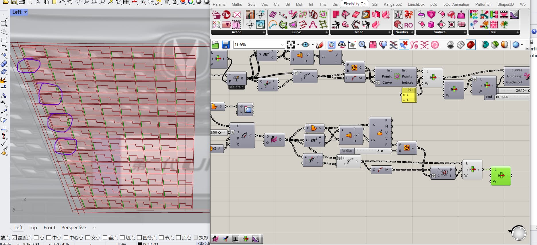

i want to use to sort a group of line, most element is sorted well, but there are some element that have problem in sorting. when i list item, some of them have different sequence.

the segments are sorted correctly along the circles
the problem is that some circles are created on Planes that are rotated almost 180°, and so the start of your sorting curve lies on the opposite side:
thanks, i didn’t notice this problem on circle. However, this is not my intention to have this rotated circle. so, why this happen, and how can i solve this issue?
I think the easiest and fastest solution would be to align all the planes on which the circles are built with an external vector, for instance this aligns the planes with vector Z:
