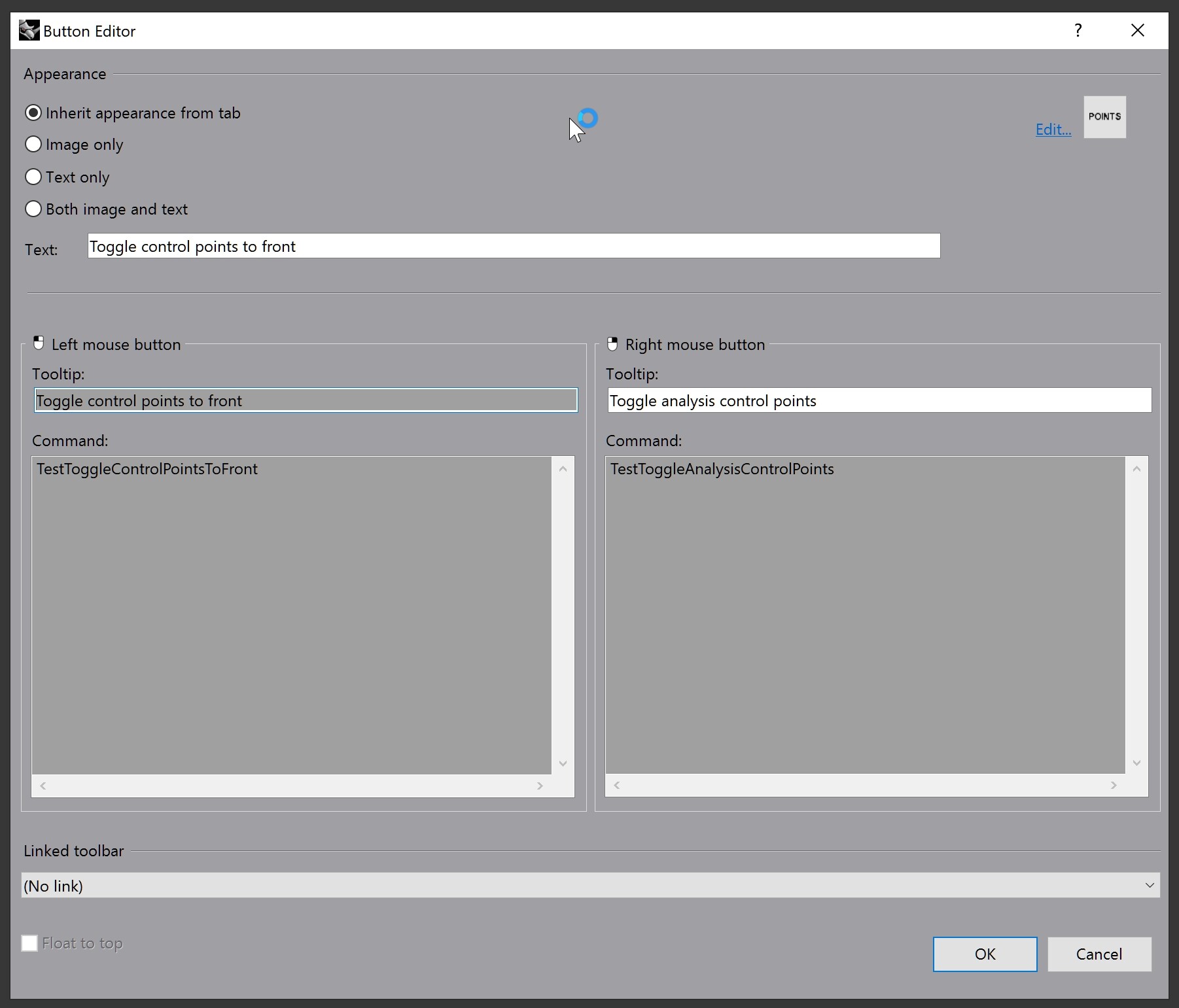

Rhino has these two test commands to toggle the wireframe’s visibility:
Icon 32x32:
Text: Toggle control points to front
Tooltip for the left mouse button: Toggle control points to front
Command: TestToggleControlPointsToFront
Tooltip for the right mouse button: Toggle analysis control points
Command: TestToggleAnalysisControlPoints

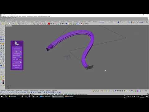

IMPORTANT: First, you have to run the ! _Block command to convert the closed curve profile into a block, then it can be selected as a profile.
Download the Super sweep plug-in from here:
https://www.food4rhino.com/en/app/super-sweep
How to use:
