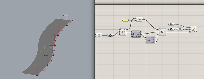

Question with (probably) a very simple answer. I have this curve divided up and I need to be able to select alternating points (so basically one yes, one no) to apply a different object to said points as shown in the second picture.

Try Cull Nth

You would also want to Cull Nith the T data coming out of the Divide Curve as well. To keep the branches matched.
Dispatch might work better if its a simple True/False and you want both
which plugin is this ?
