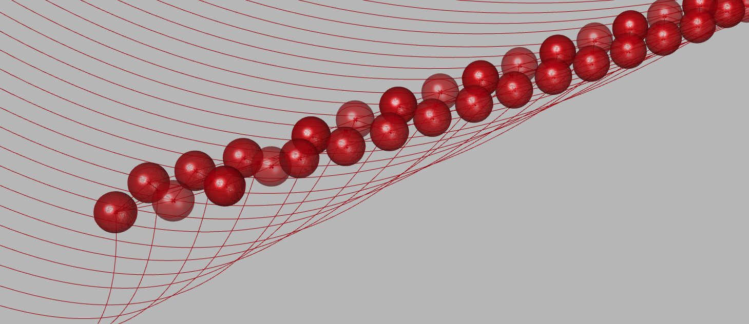

I’ve managed to simulate spheres bunching like this but I’m not sure how to add the tubes in way that they will collide.

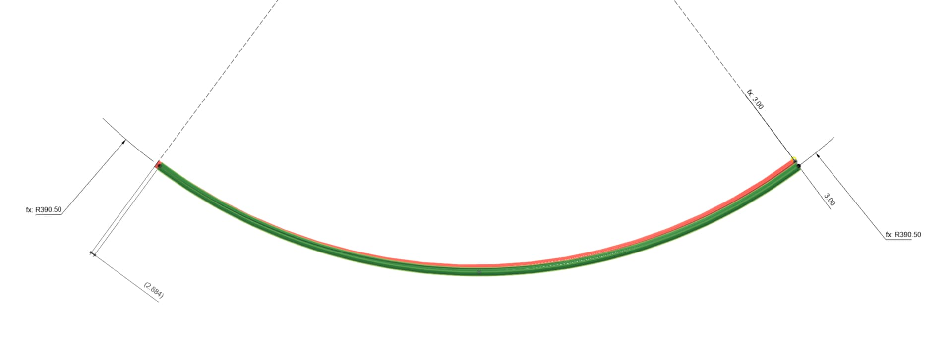

Assuming the materials are rigid, simple semicircular arcs of increasing radii, the goal is to create this sort of interlaced stacking but have the ends of the tubes wind up in a predictable position relative to each other, to create a somewhat smooth appearing edge of the assembly overall. Right now we’ve been getting some tubes poking out, mostly due I believe to the way they nest.

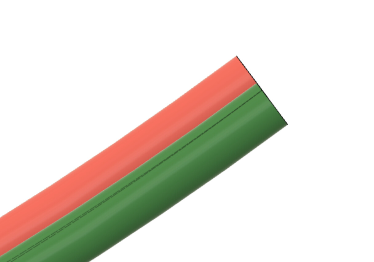

Essentially, nesting two arcs of the same length but different radii, the flatter tube longer chord length and project more if the ends are lined up on one side. In this case, the arc radius increases along the length of the assembly, and due to the stacking pattern, in each pair of tubes there is an alternation between whether the big spoon (tube on bottom) is a larger or smaller radius.
This diagram is a model of one pair of identical tubes which are diagonally stacked on one side, and side by side on the other side and manually adjusted to try to minimize intersection while still being as close as possible.

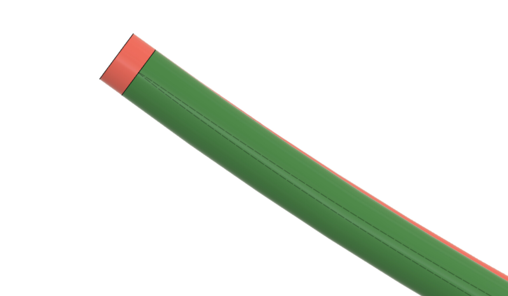

You can see that the red tube projects by 2.8mm on the left due to the way the length of the green tube is “consumed” by trying to cross over the red tube.
Essentially the goal is to be able to control or the relationship of the tube endpoints in these assemblies by adjusting the arc lengths, in this case I could make the tube ends come even by lengthening the red tube by 2.8mm.
