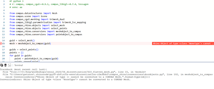

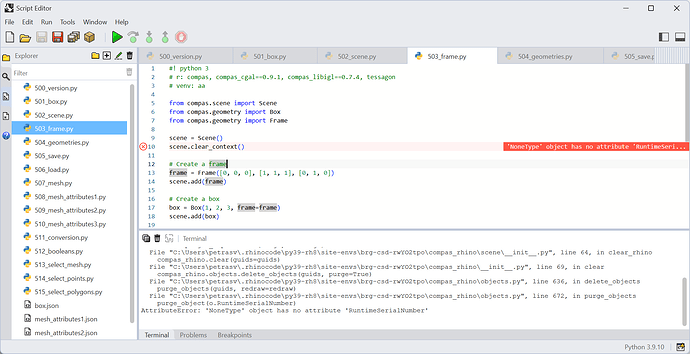

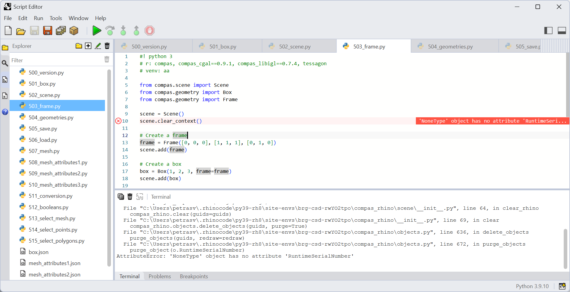

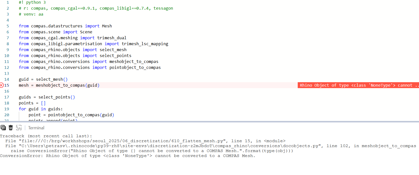

compas_rhino selection methods (essentially bunch of rhinoscript selection methods) has a strange bug:
selection commands works on a freshly opened rhino version
when you open a new file in an existing rhino file, these commands are not found
only way to make this work is to restart rhino
I think this is a rhino bug, that we cannot solve for a decade…

The code is here, it is a scripeditor python project:

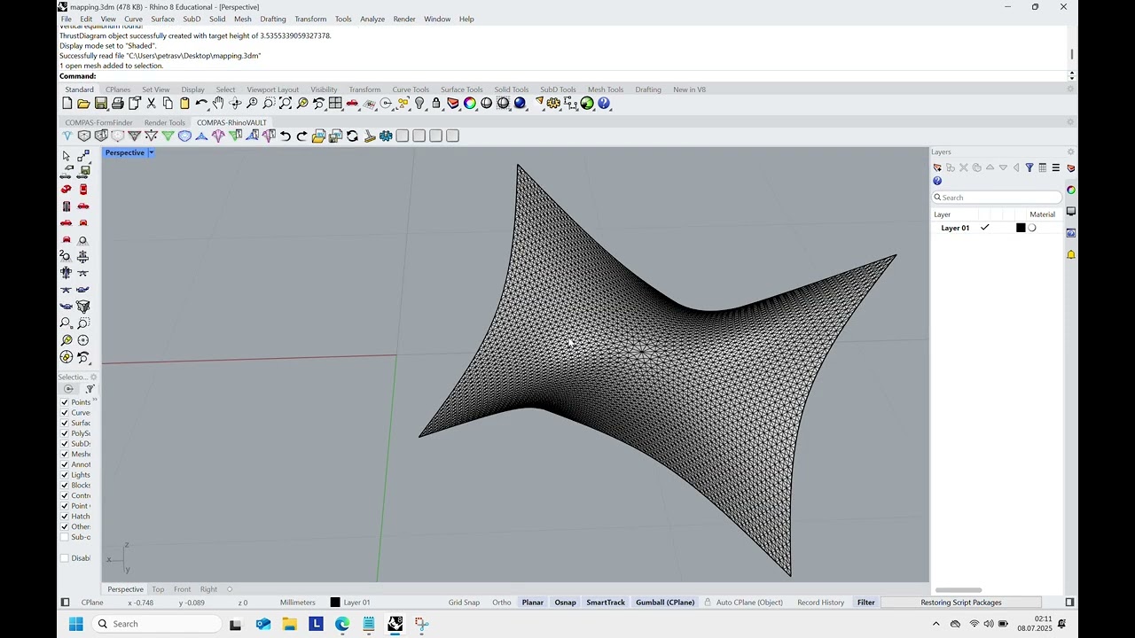

Look at the end of the video 1:16 minute, when I open a new rhino file on existing one. Any selection command from python results in an error:
Error:
Command: _RV_pattern_supports
Add or Remove supports ( Add Remove ): Add
Traceback (most recent call last):
File "file:///C:/Users/petrasv/.rhinocode/stage/4bxlfksa.dha", line 99, in <module>
File "file:///C:/Users/petrasv/.rhinocode/stage/4bxlfksa.dha", line 61, in RunCommand
File "C:\Users\petrasv\.rhinocode\py39-rh8\site-envs\brg-csd-5H3xDoTG\compas_rv\scene\patternobject.py", line 80, in redraw
self.clear()
File "C:\Users\petrasv\.rhinocode\py39-rh8\site-envs\brg-csd-5H3xDoTG\compas_rui\scene\meshobject.py", line 522, in clear
super().clear()
File "C:\Users\petrasv\.rhinocode\py39-rh8\site-envs\brg-csd-5H3xDoTG\compas_rhino\scene\meshobject.py", line 76, in clear
compas_rhino.objects.delete_objects(self.guids, purge=True)
File "C:\Users\petrasv\.rhinocode\py39-rh8\site-envs\brg-csd-5H3xDoTG\compas_rhino\objects.py", line 636, in delete_objects
purge_objects(guids, redraw=redraw)
File "C:\Users\petrasv\.rhinocode\py39-rh8\site-envs\brg-csd-5H3xDoTG\compas_rhino\objects.py", line 672, in purge_objects
purge_object(o.RuntimeSerialNumber)
AttributeError: 'NoneType' object has no attribute 'RuntimeSerialNumber'
