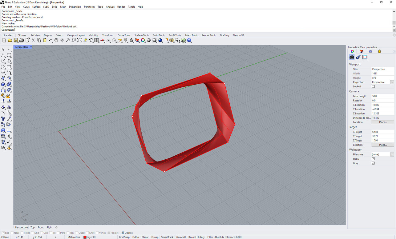

I am lofting over 2 line objects using rhino script in rhino 7.
When running the script loft the result is a distorted loft. When I run the loft manually it works fine.
I’ve uploaded screen shots of both results. I can force the manual loft to look like the script loft
by moving the loft pointers that appear but I don’t how to do the same in the script.
Here’s the script I ran.

I can’t tell fur sure from your pictures, but it looks like the start/end of the curves aren’t aligned.
The curves have to be set up to match before you call AddLoftSrf.
I tried using start/end but ended up with a hideous looking blob so I gave up on that. I guess I wasn’t using that option properly. Do you know where I can get some documentation on how to use this option.
