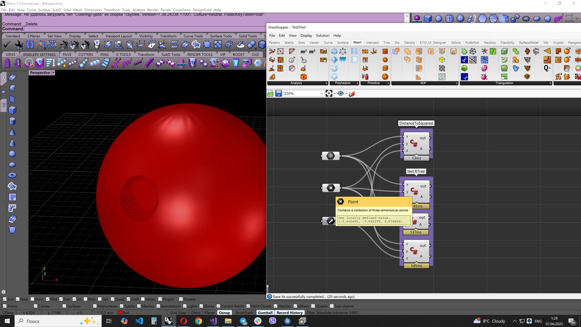

RTree Why is the use of the RTree so slow?
Why is wood used so slowly? Or am I using it wrong? I thought it was supposed to give privileges in a fast search.
 public class Test
        public Test(Mesh inputMesh)
            mesh = inputMesh;
            CreateRTree();
        public Mesh mesh { get; private set; }
        private RTree rTree;
        private List<int> affectedVertices;
        public void CreateRTree()
            rTree = new RTree();
            for (int i = 0; i < mesh.Vertices.Count; i++)
                rTree.Insert(mesh.Vertices[i], i);
        public void SearchRadius(Point3d centr, double radius)
            affectedVertices = new List<int>();
            rTree.Search(new Sphere(centr, radius), (sender, args) =>
                affectedVertices.Add(args.Id);
        public void ApplyMove(Point3d centr, Vector3d moveDirection, double intensity, double radius)
            if (affectedVertices.Count == 0)
                return;
            Vector3d scaledDirection = moveDirection * intensity;
            Vector3f moveDirectionF = (Vector3f)scaledDirection;
            Parallel.ForEach(affectedVertices, vertexIndex =>
                Point3d original = mesh.Vertices[vertexIndex];
                double distance = original.DistanceToSquared(centr);
                double factor = 0.5 * (1 + Math.Cos(Math.PI * (distance / (radius * radius))));
                mesh.Vertices.SetVertex(vertexIndex, original + moveDirectionF * (float)factor);
TestTree.gh (3.5 MB)
TestTree2.gh (3.5 MB)
I realized my mistake. I should have split the creation of the Tree. :sweat_smile:
