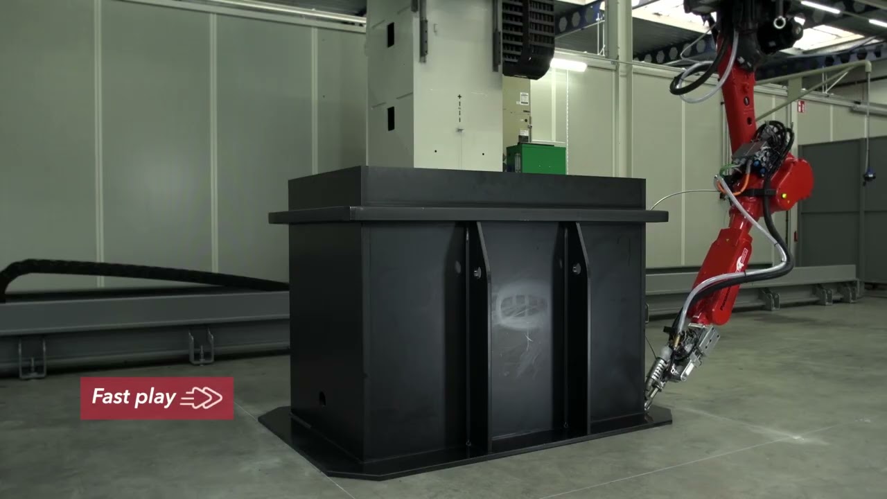

At the moment I am studing Grasshopper programming.
One more stupid question regarding to robotic arm programming with Grasshopper.
What do you think, is it possible to use Grasshopper robotic arm programming for plastic extrusion welding.
Here is just one video for reference.
Thank You!
Yes, definitively possible. Most of the Robot Control packages support external axis and analog/digital input/output, which lets you control your tool.
