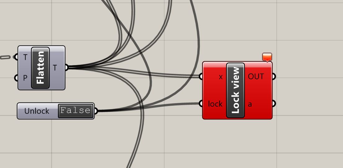

I’m trying to lock 3D views. I haven’t been able to find any OOTB components so trying with Python. Any ideas why I am getting an error:
Runtime error (TypeErrorException): iteration over non-sequence of type View3D

Does ‘x’ have list access?
Your script is using Dynamo API.
In order to make it work on Rhino.Inside.Revit you need to change it a bit.

This is my GH file.
As @devin_jernigan said ‘views’ should have list acces.

Please share an screenshot of your Grasshopper document.
This will help me to understand better how you are connecting the components.
@kike yes sort of but let me explain…
If I created a view manually and locked it, I would expect that the lock operation is the dominate control. However, if I create a view with RIR and lock it downstream, I would expect that the view create is the dominant control.
I guess it comes down to separate transactions and their sequence. The way that I have it as two separate transactions means that once the view is locked, I can’t re-run the script easily. What I would need to do is collect all the views, filter them out, unlock them and then re-run the original script.
Although looking at it again, even if the views are locked, views are still output from the add 3d view component, so I can undo the lock after they are created. But it is still a bit awkward.
I guess if we could combine it into the same transaction, i.e. with Add 3D view, this would simplify the workflow. Just a thought…
