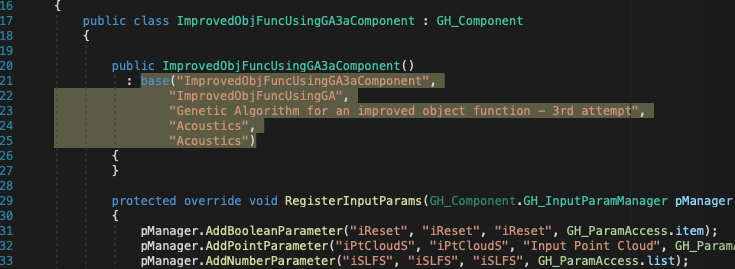

I tried something that actually gets the Breakpoints to work for a little while when the program and Grasshopper are just starting out. I initialize some variables before I actually get into the component (it’s a recursive Genetic Algorithm). VS finds the Breakpoint, initialises a dozen or so variables then moves to the lines highlighted in green in the following image.

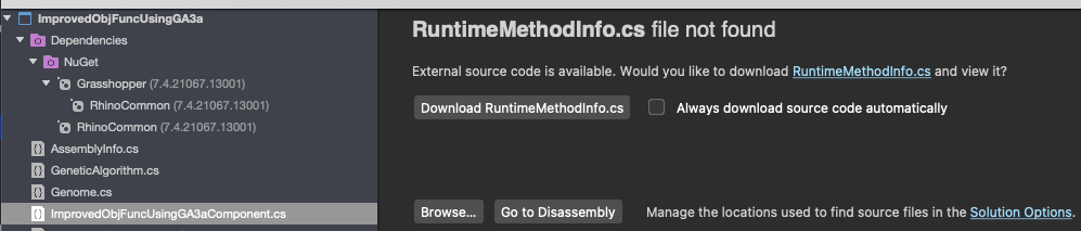

When it exits that, after to two {}’s it throws up the following error.
The program hasn’t started yet, Grasshopper is still initialising. After that, if I click on Run/Continue Debugging in VS, Grasshopper will finish loading but the component is, in effect, dead. Or at least it appears that way. The programme is a copy of a previous one that was running but there might have been some errors introduced in my copy. The component isn’t showing any errors, but no output either.
A few more things to note that may or may not help. When I screen copied the error message above, I included something funny looking on the left. RhinoCommon seems to be loaded twice. I can’t get rid of the one that seems to be in a subdirectory of Grasshopper. As you can see from the csproj file though, RhinoCommon only appears to be loading once.

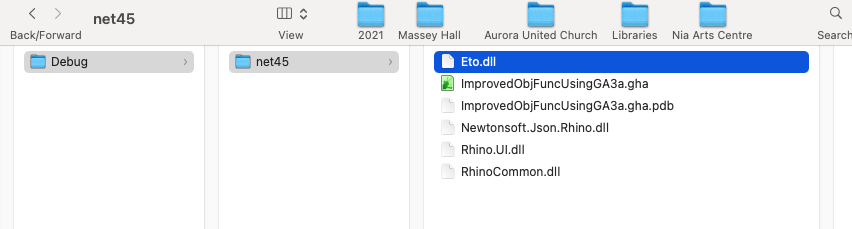

Finally, VS, Rhino or both seem to be creating some dll files in my Bin/Debug/net45 directory that I haven’t seen before. Here’s an image showing their names.

The issue you’re running into is due to a problem with our Grasshopper Nuget Package, where it causes the RhinoCommon assemblies to go into your output. There’s RH-63423 to fix that up which I will get to asap.
For now, you can add IncludeAssets="compile;build" to your PackageReferences like so, and ensure none of the extra .dll’s are in your output directory:
    <PackageReference Include="RhinoCommon" Version="7.4.21067.13001" IncludeAssets="compile;build" />
    <PackageReference Include="Grasshopper" Version="7.4.21067.13001" IncludeAssets="compile;build" />
Hope this helps!
