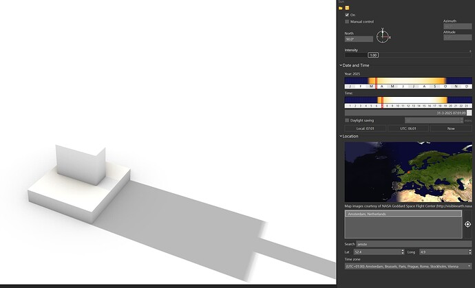

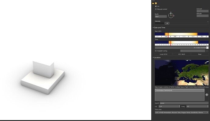

Shadows are not working in Direct3D:
OpenGL:
Yep…it’s on my list. I just haven’t gotten to it yet due to more pressing functional issues regarding DirectX atm.
