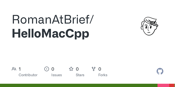

Hi @andy and @dan
I am trying to setup VSCode to run Mac SDK. It seems to be working.
But I am getting typical C++ linking errors. Can’t find AfxMac.h?
Here is git hub link
Also does not seem to run using Xcode. I left an issue on GitHub.
@arten
You must have these preprocessor defines for Debug builds:
GCC_PREPROCESSOR_DEFINITIONS = $(inherited) ON_COMPILER_CLANG ON_RUNTIME_APPLE RHINO_APPLE=1 _DEBUG=1 _GNU_SOURCE MY_ZCALLOC Z_PREFIX ON__DEBUG _UNICODE RHINO_V6_READY RHINO_THIRD_PARTY_OSX_PLUGIN_COMPILE
and this for Release:
GCC_PREPROCESSOR_DEFINITIONS = $(inherited) ON_COMPILER_CLANG ON_RUNTIME_APPLE RHINO_APPLE=1 _GNU_SOURCE MY_ZCALLOC Z_PREFIX NDEBUG=1 _UNICODE RHINO_V6_READY RHINO_THIRD_PARTY_OSX_PLUGIN_COMPILE
You’re using CMAKE - so I assume there is a way of defining those in the make file.
  • Andy
I don’t see any issues on the Github repo. What am I missing here?
