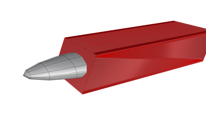

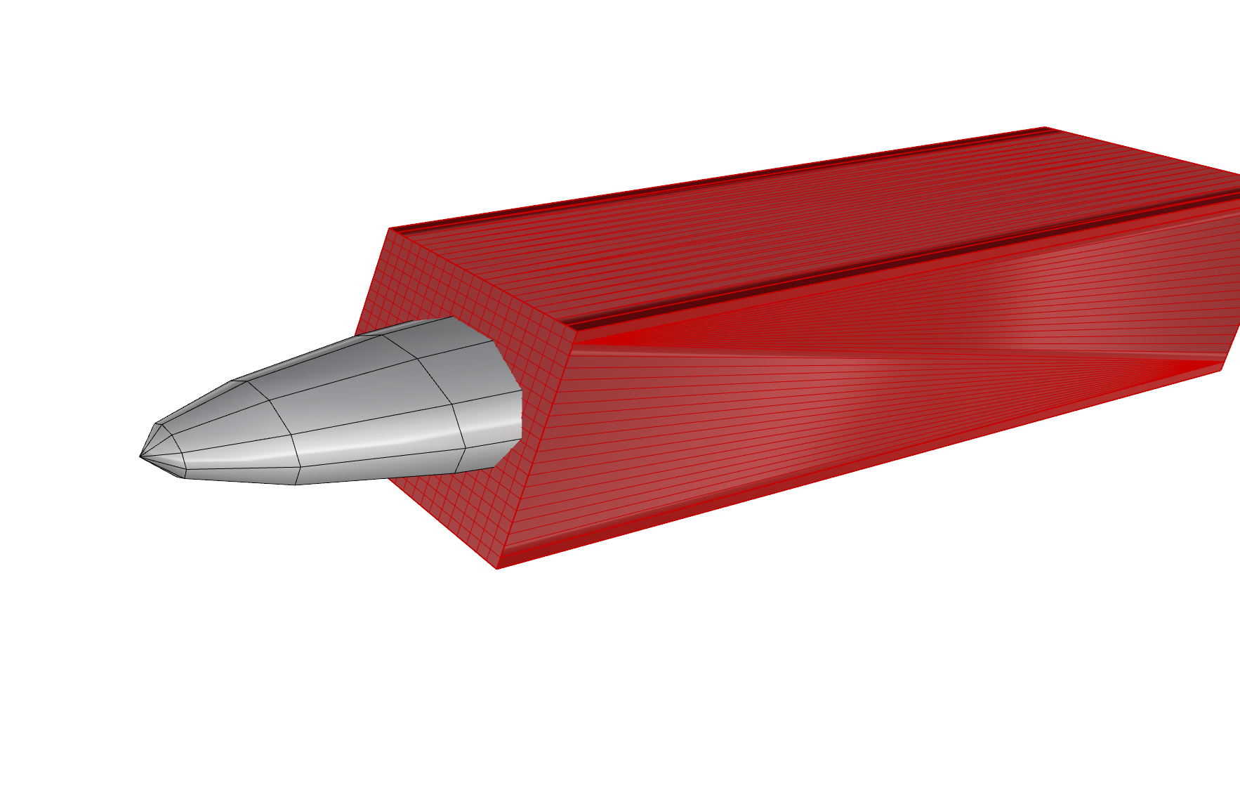

For reference, the single mesh surface as a cutter is the current trouble. If that surface was part of a box that enclosed half the model, then MeshBooleanSplit can still be used and will result in the correct split. Perhaps in the short run that will help as a workaround?
I can send you the results of my testing if you need.
Here is an illustration of the problem with a different model.
This will be a problem at this time:
This will work:
