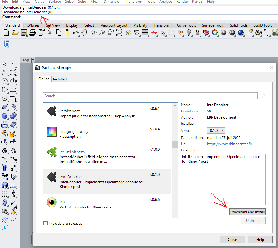

Hi, I just tried to install the intel denoiser on v7 and I hit the Download and Install button multiple times because there is no apparent feedback on the click.
So please add a response and a download progress bar.
Or turn the download and install button green and type Downloading… on it :slight_smile: That would make it much more user friendly.
Thanks for the feedback! I’ve already made some changes to the UI during downloads and I’m continuing to work on it. Please try the latest Rhino 7 WIP from earlier this week and let me know if it’s an improvement.
