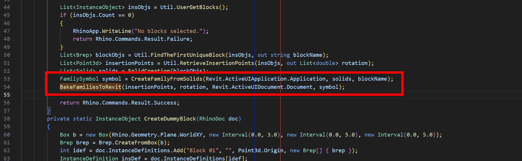

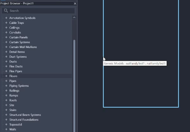

I am trying to create a Rhino plugin running inside of Rhino.Inside-Revit to convert Rhino Block Instances to Revit families. After testing, the family shows up perfectly in the viewport, but there is no where to find it in the Revit Project Browser panel. Although I had confirmed the family was successfully created in the backend.
Meanwhile, I tried to use the Family-New component in Rhino.Inside-Revit Grasshopper and the Revit Project Browser responded instantly. Amazing - but I cannot find any clue in the doc here:
Rhino.Inside-Revit-Family-New on Github
So - what is causing Revit ignoring the new family and why? What is the secret sauce in the Rhino.Inside-Revit Grasshopper?

Screenshot and code attached here:
// -- build the family document -------------------------------------------------
var famDoc = revitApp.NewFamilyDocument(templatePath);
using (var t = new Transaction(famDoc, "Build geometry"))
    t.Start();
    foreach (var s in solids)
        FreeFormElement.Create(famDoc, s);
    if (famDoc.FamilyManager.Types.Size == 0)
        famDoc.FamilyManager.NewType("Default");
    t.Commit();
// -- load the family into the current project ----------------------------------
var hostDoc = Revit.ActiveUIDocument.Document;
Family loadedFamily;
loadedFamily = famDoc.LoadFamily(hostDoc, new SimpleFamilyLoadOptions());
famDoc.Close(false);
FamilySymbol symbol =
    hostDoc.GetElement(loadedFamily.GetFamilySymbolIds().First()) as FamilySymbol;
using (var t = new Transaction(hostDoc, "Rename family"))
    t.Start();
    symbol.Activate();
    try { loadedFamily.Name = familyName; } catch { }
    try { symbol.Name = familyName; } catch { }
    FamilyInstance instance = hostDoc.Create.NewFamilyInstance(
        new XYZ(0, 0, 0),
        symbol,
        DB.Structure.StructuralType.NonStructural);
    hostDoc.Regenerate();
    t.Commit();

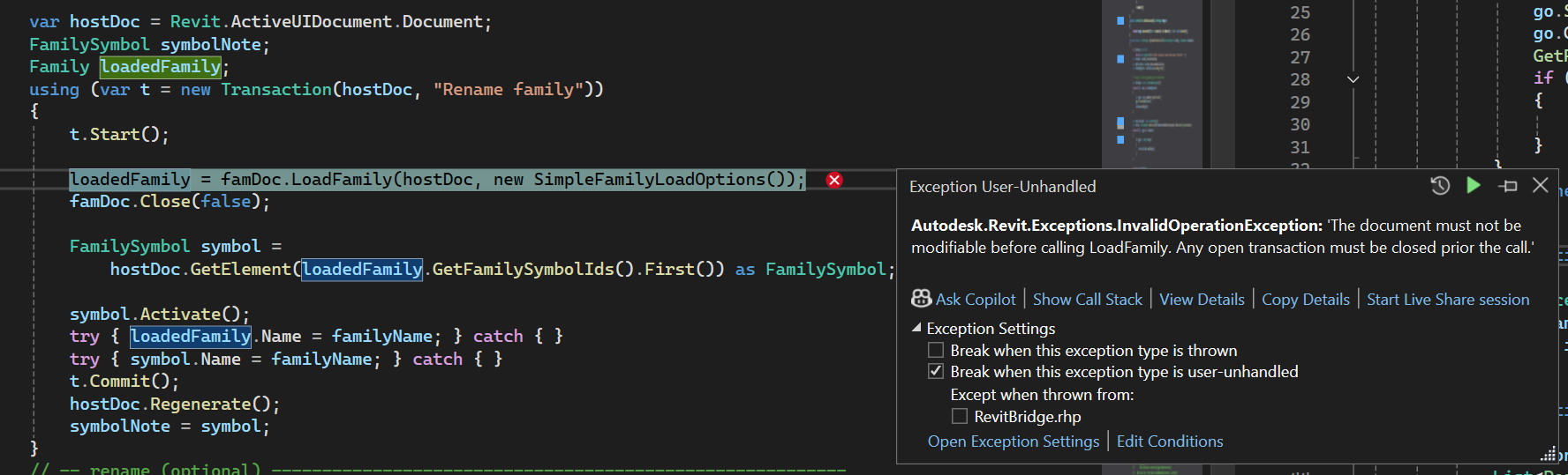

Try loading family inside the transaction
tx.Start();
tx.Commit();
Thank you for the response!
I’ve tried this before, but got this message:
The document must not be modifiable before calling LoadFamily. Any open transaction must be closed prior the call.
It seems like I cannot use transaction to load the model.
Looking forward to your reply!
Like this not separate transaction
using (var t = new Transaction(hostDoc, “Rename family”))
t.Start();
symbol.Activate();
    new XYZ(0, 0, 0),
    symbol,
t.Commit();
Unfortunately, it doesn’t change the result…
I assume you are in another command , this command needs to stop first before starting a new transaction, likely the RIR is being considered as a new command.
That is an interesting point - if you see RIR as a command, then this is indeed inside of it.
Although, if you look at my code at the uppermost post, this family loading is outside of a Transaction and it won’t trigger error like the one Muhammad suggested.

I ended up solving this issue by using another thread - not what I planned to do, but it works in an unexpected way.
            ExternalRunner.Instance.RunAsync(app =>
                var doc = app.ActiveUIDocument.Document;
                using (var t = new TransactionGroup(doc, "Populate family"))
                    t.Start();
                    FamilySymbol symbol = CreateFamilyFromSolids(Revit.ActiveUIApplication.Application, solids, blockName);
                    BakeFamiliesToRevit(insertionPoints, rotation, doc, symbol);
                    t.Assimilate();
That’s a good solution; it is way above my cognitive ability.
Hi @yiliang,
ExternalRunner.Instance.RunAsync is asynchronous, if you need something synchronous and without referencing any Dynamo assembly please try this.
using RhinoInside.Revit;
using ARDB = Autodesk.Revit.DB;
ARDB.FamilySymbol PopulateFamily(IEnumerable<Point3d> points, double rotation, string blockName, IEnumerable<Brep> solids)
  return Rhinoceros.InvokeInHostContext(() =>
    var doc = Revit.ActiveUIDocument.Document;
    using (var t = new ARDB.TransactionGroup(doc, "Populate family"))
    t.Start();
    ARDB.FamilySymbol symbol = CreateFamilyFromSolids(doc.Application, solids, blockName);
    t.Assimilate();
    return symbol;
Oh that is even better! Thank you Kike
