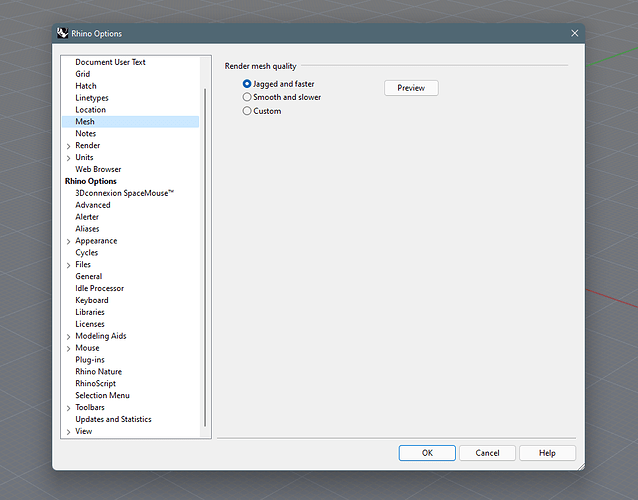

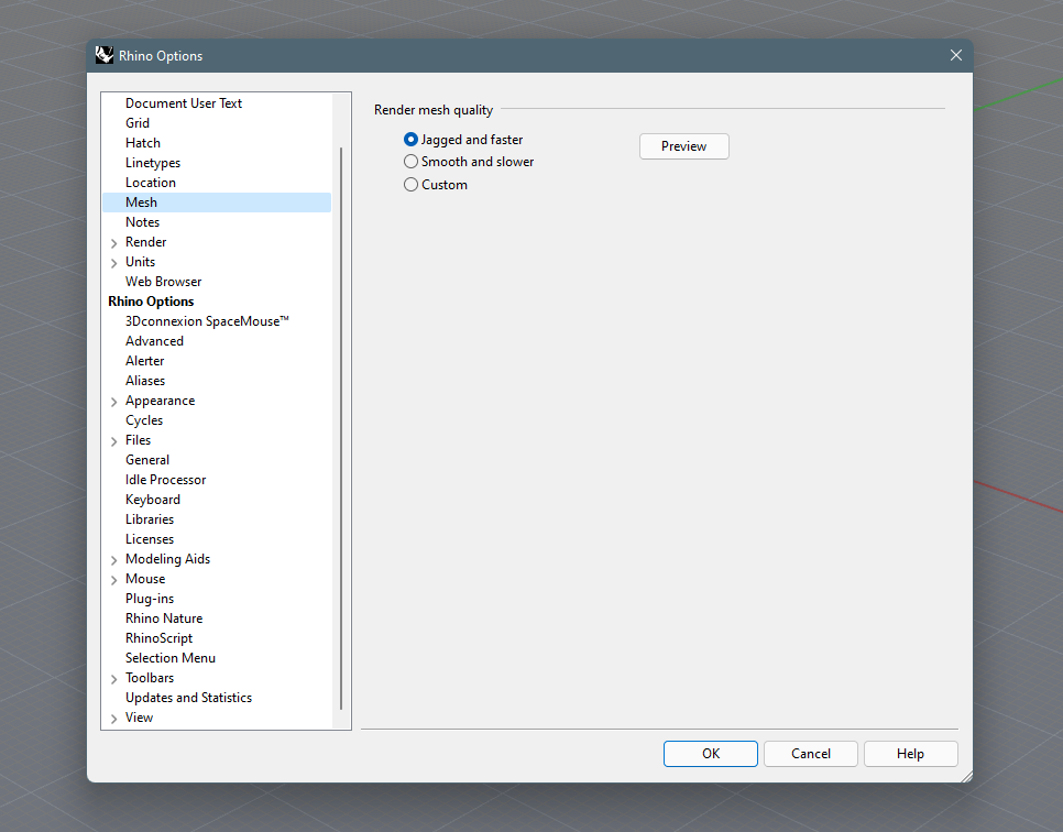

I usually keep my rendermeshes as Jagged and faster, and If needed I can modify the custom mesh for individual objects in the object properties panel.
