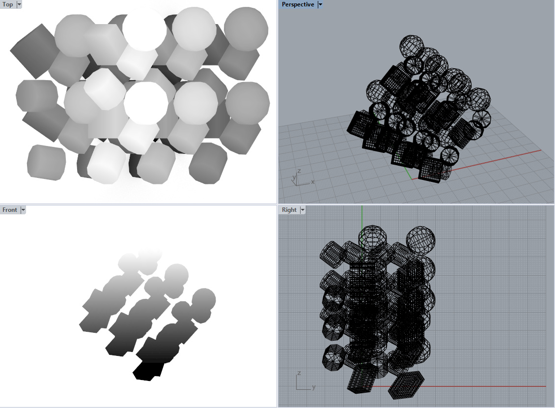

I tried to build Z-depth map of a view and to export floating point data to a binary file.
I am using Rhinocommon and c# for the project.
A part of the code for illustration is:
Rhino.Display.ZBufferCapture zb = new Rhino.Display.ZBufferCapture(viewport);
Single[] sa = new Single[xsize * ysize];
sa[iy*xsize + ix] = zb.ZValueAt(ix, iy);
It works fine but there are two problems:
  1. Data from ZValueAt() is scaled to 0.0…1.0 and can’t be compared to other exports even at the same object in different view (camera) position.
  2. Even the view size can be set to arbitrary value (for example 4000x4000) only the area of the screen (in case of HD screen approximately 1920x1080) is filled with a data.
    I can’t find any example and documentation about usage of Rhino.Display.ZBufferCapture class.
Does anybody have experience with it?
Thank you in advance
the 0.0 to 1.0 zero range adapts to the visible geometry bounding box, so it changes when you change the view. Then the 0-1 range is not linear, so you cant just map it into space even if you would get the proper data.
This is related to a common problem - when you switch the view to zbuffer (forgot the command) and make a bigger viewportcapture (rhino command) every patch will have different grayscale ranges.
All in all you probably will be happier just running a few million ray intersections with the geometry while having a coffee break. And best use the rendermeshes instead of the nurbs for intersection - because the coffeebreak could otherwise become a vacation…
side note:
It is similar to rendering (not in Rhino) where you can (painfully) extract data from a zbuffer pass, but everyone is using the position pass for that (rgb = xyz)…

I’m trying to build Z-depth map of a view and to export floating point data to a binary file.
Excuse my not perfect English. I will try to explain the idea in more details.
I need a Z-depth map (2.5 D) of an object or scene designed in Rhino3D for processing the data outside the Rhino3D. The resulting “image” should have dimensions about 4000x4000 pixels and more and floating-point precision.
Previously I was using a vertical line and calculating the cross point with a maximum Z coordinate of this line and every object in the scene. Moving this line across X and Y coordinates and finding Z of the cross points I achieve required Z-depth map. This algorithm works fine, but it’s very slow if the object is nurbs object or the mesh with many nodes.
I tried to use the functionality of z-buffer class and the result is excellent for small objects when the output “image” ( bitmap if using command _ShowZBuffer) is smaller than the resolution of the viewport size in my case full HD 1920x1080.
Best regards
Maybe you can get a speed gain by using a workflow like so:
  • get all the meshes from the geometry
  • you can join all meshes into one for ease of bookkeeping
  • for each mesh vertex, calculate the distance to camera point or camera plane ( depending on the desired projection)
  • for each vertex calculate the normalized depth value
  • apply vertextcolors with grayscale value based on normalized depth
  • hide all document geometry and add the mesh with vertex colors
  • make sure you have a displaymode that displays the mesh with vertexcolors correctly
  • capture the viewport at desired size.
Does this make sense?
It might still be slow but I suspect it might be faster than sampling the mesh for every point
You could maybe optimize by culling faces that point away from the view
-Willem
