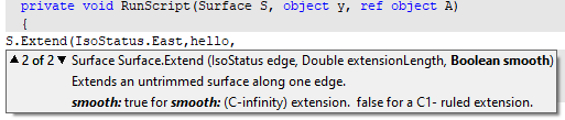

- Inside a method you canāt directly use āintellisenseā of a parameter (like IsoStatus. in the video)
- the āuseless listā still pops even if i toggle
please give an option to nuke it forever. - writing a method the amount of commas is not always used, sometime you type 2 commas, expecting to use the overload with 3 parameters, but the floating windows still displays the overload with 2 parameters

and after the second comma it switch to the overload with 3 parameters:

I looked at it a bit and know whatās going on and will fix it.
Until then itās best to keep āautocomplete in function helpā on.
