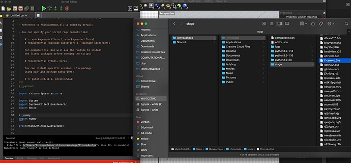

So here is my rookie question. I am running the script editor (Rhino WIP) in both Mac and Windows, and when I try to import numpy (or another package from pip), I get this error:
The error on the Windows side says:
Traceback (most recent call last): File “file:///C:/Users/85lpa/.rhinocode/stage/nsyzfugx.1br”, line 30, in NameError: name ‘numpy’ is not defined
I have tried to install the package using “pip install numpy” but same, same.
Do I need to point the ScriptEditor to a special folder? Do I need to switch RhinoWIP to Python 3 somehow?

Try placing a # at the beginning of line 30
Thanks, @stevebaer!
I get it now!
I would also recommend placing these #r: numpy statement at the beginning of your script right after #! python3. This will be a little easier to read.

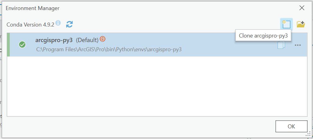

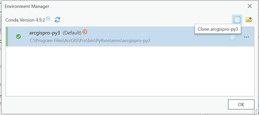

(1) I really like the way ArcGIS Pro handles Python integration. ArcGIS Pro comes with an installation of conda, a GUI for managing Python environments and packages with conda (see images below) and an ArcGIS Pro Python Command Prompt (+ docs) for advanced users.
When you want to install additional Python packages for use with ArcGIS Pro, you have to create a new Python environment, for which you have to clone the Python environment that comes with ArcGIS Pro by default (see the warning in img 1 & img 2 above). This way, users cannot mess up the original Python environment, but do have the freedom to experiment with different Python environments and install any package they want.
(2) If you want to keep the requirements of a Python 3 script in Rhino 8 contained in the script, what about putting the requirements.txt or conda-env.yml in a

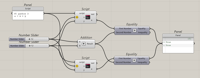

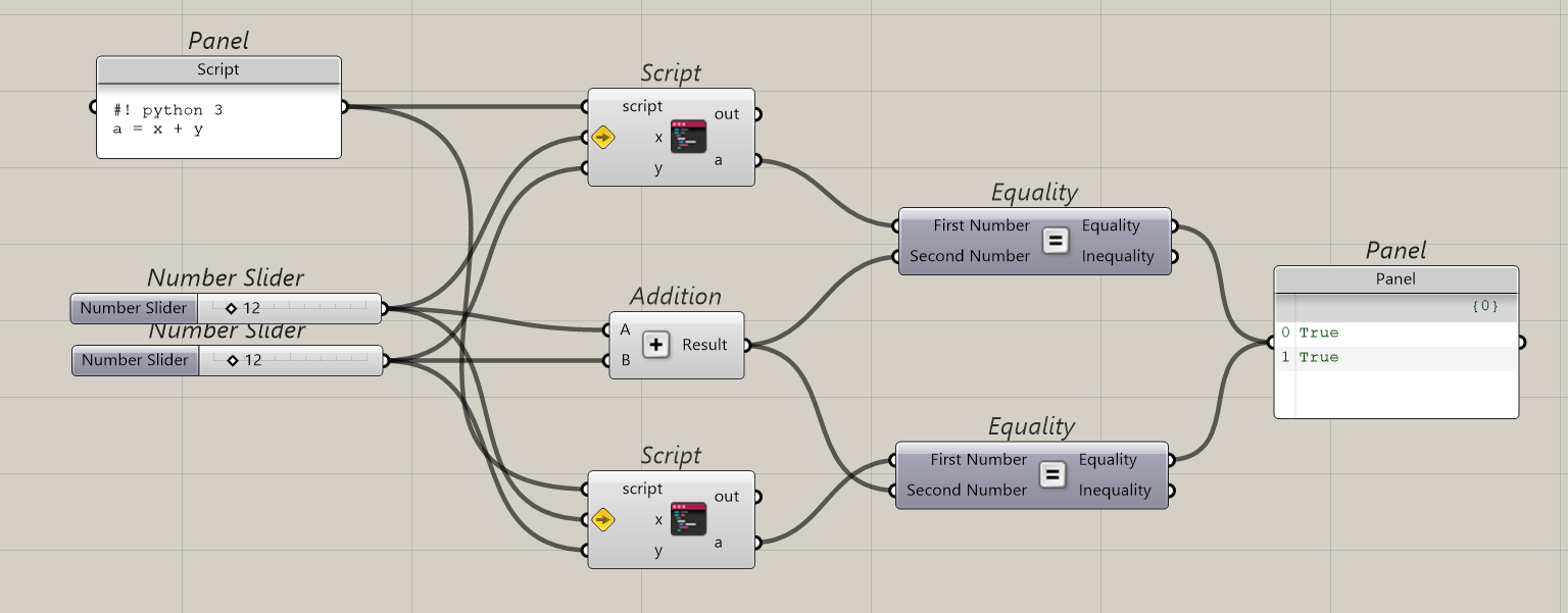

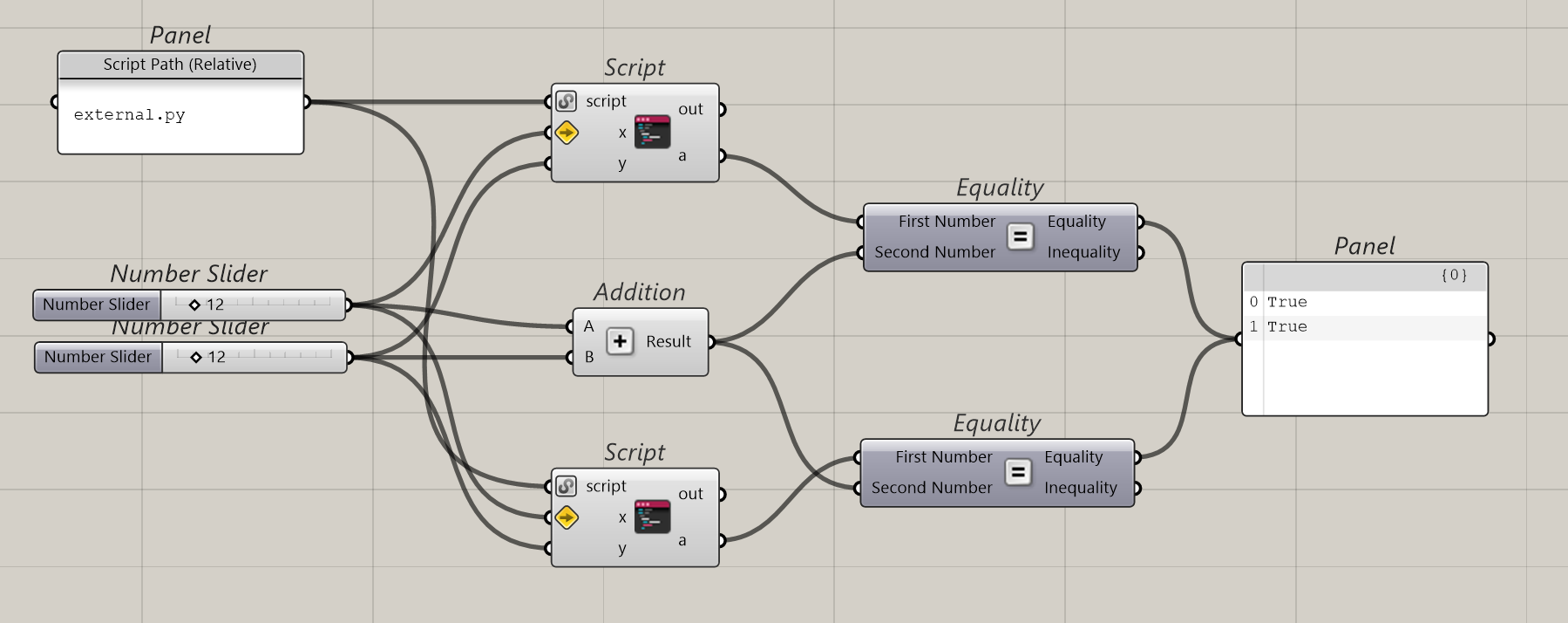

As for the ability to load/save the code from GHPython script with new editor it is actually possible to link it to an outside file right now by saving from the editor. Then even outside rhino modifications will be taken into account. BUT if you copy/paste the component in order to have several components linked to the same file, the link in the second component is broken. You can see that it does refer to an external file anymore. Is this intended behaviour ? Is there a copy component option to keep the link with the external python file ?

@thomas.pitiot Hold Shift and right-click on the component and activate Script input. Then either put the script text in a panel and feed into as many Script components this way, or put the path of the script in a panel and feed into this parameter.
If placing script text in a panel, make sure to add the language specifier line as #! python 3 for this example so the component can determine the language:
If using external paths, make sure to right-click on Script parameter and set that and Input is Path. In this example, external.py is a python file in the same directory as the grasshopper definition so the path is relative and full path is automatically computed:
