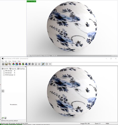

Not sure how you set up the render, but here a simple sphere with spherical texture mapping and the Blue flower print material from the Rhino render content library. Just simple skylight RDJ Window, also from the Rhino render content library.
This is with the Raytraced viewport and the Rhino Render.
The above is with shadows-only ground plane, with a proper material on the ground plane you get a bit better shading/lighting with otherwise same setup.
