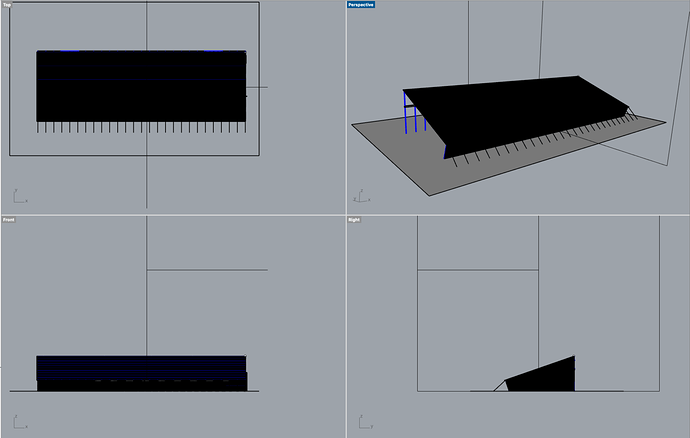

Rhino 6 for Mac Display Errors (Clipping Plane and Top View)
Problem only seems to happen when clipping planes are enabled or when looking at the model from top view.

Hello - does this happen with any file?Say a new file with just a box? If not, can you please post or send to tech@mcneel.com a file that shows the problem, along with a link back to this topic?
I think I found an existing bug report for this.
Unfortunately, it is not open for public view:
https://mcneel.myjetbrains.com/youtrack/issue/RH-54879
It’s on the list and the developer knows about it.
Hi, thanks for getting back to me! It doesn’t happen with a simple box, but seems to happen with more complex shapes. I’ve attached a file (a solid extrusion of a closed curve with the clipping plane enabled) that displays a similar error. EDIT: The error only seems to happen when curves are present—if I hide the curves, everything works as expected. ClippingPlaneError.3dm (3.4 MB)

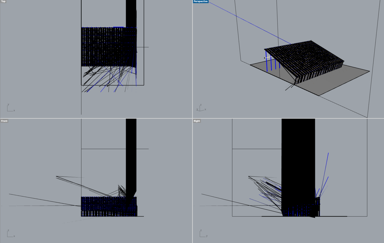

Here is an image of what the error looks like in wireframe view:
We believe this issue may be fixed in the latest Release Candidate for 6.21. Please give it a try and let us know.
Hi Recently upgraded to R6 & Catalina have just attempted to create a clipping plane after a day or so modelling.
Im getting a lot of crazy geometry when the clipping plane is active In all view ports it doesn’t happen on a simple file like a single box a previously discussed. I Wondered if it was something to do with the blocks in the file but i have removed them all and makes no difference, and it’s telling me there’s no bad objects.

Hi! Have you tried the 6.21 Release Candidate? If that doesn’t solve it, one workaround I found was to hide all curves, lines, and polylines.
Hi thanks for your feed back yes i’m on 6.21 and just tried hiding curves, lines,and polylines but unfortunately none of the above solve my issue.
I do hope they can resolve this quickly as my workflow needs to use clipping planes & make 2d but i haven’t had any success with that either.
Hi - YT item RH-54879 is still open and is sadly not something that is easily reproducible on all hardware. Because of that, there’s no easy fix.
Just to make sure that I completely understand this. You are NOT saying that this is something that started happening on your hardware when you installed Catalina, right? You rather upgraded to RH6 and Catalina at the same time or didn’t use clipping planes on RH6 before installing Catalina?
About Make2D - the output of that command isn’t affected by this display issue with clipping planes. I see that it takes a very long time to generate the 2D output on my performant PC but there doesn’t seem to be (much) wrong with the result. Are you seeing something else?

@wim Hello Just an up date I have gone back to using Rhino 5 for Mac as a workaround the file works as expected in Rhino 5 but Generates a lot of unwanted Geometry In Rhino 6 when using the clipping planes. I know you’ve said this in not an easy fix but Im wondering if you know if there is any progress with this issue as i would like to go back to using Rhino 6 asap.
Kind regards
Hi - I’m afraid there hasn’t been any progress on this particular issue.
Just to make sure that I fully understand this - I see that I didn’t get an explicit confirmation on this last time. The bug in Rhino 6 is a display issue only, i.e. no extra geometry actually gets created. And the output of, e.g., Make2D is also correct (and can be checked when the clipping plane is turned off). Is that also what you are seeing?
Hi Wim
Version 6 (6.22.20028.13212, 2020-01-28) just up dated to this and it seems to have resolved my issue.
Great work team.
That’s great to hear. Thanks for letting us know.
My issue has also been resolved after updating to the most recent version (6.24.20079.23332, 2020-03-19). Thanks!
