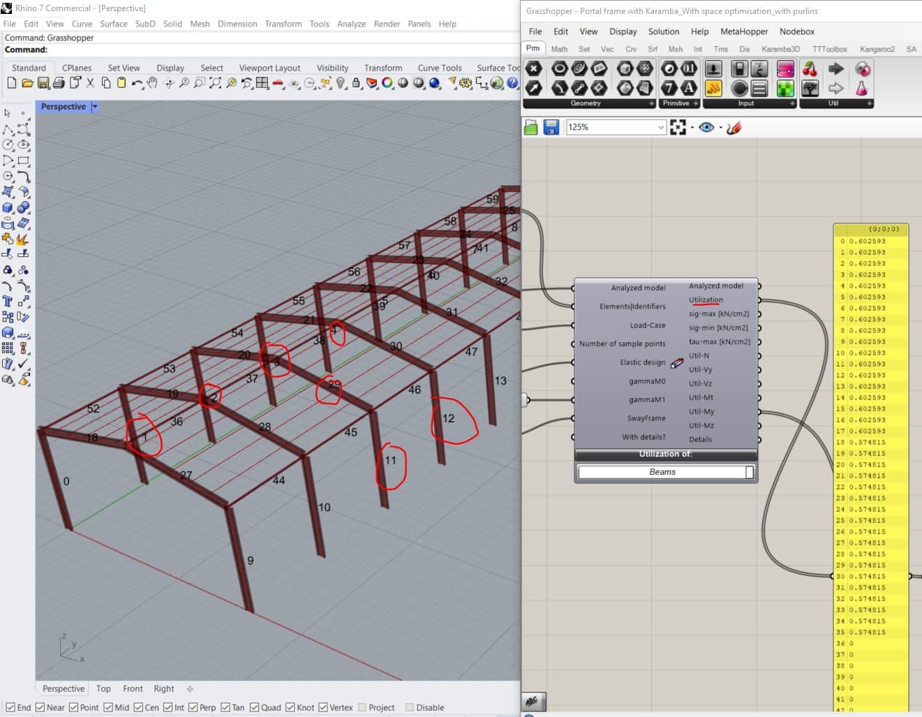

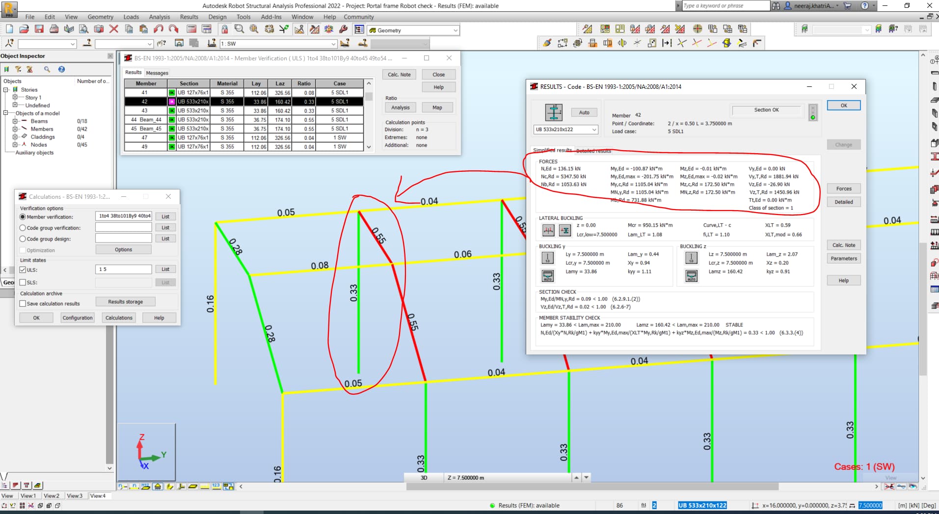

I have created a portal frame in GH & designing in Karamba and comparing results of Utilization of Elements in Karamba vs Autodesk Robot. The results seem to be similar for beams, but for columns they don’t match. Refer screenshots. Please help me on this. I am also confused how to read Karamba UR details. Refer screenshots please.
It is difficult to see the differences in the results when there are only some screenshots and the Karamba3D model.
One way is to use the values from the Details output and compare those to those of your Robot calculation to see if Robot gives you the same values. Also, check if the buckling lengths have been defined properly in both as this can also affect the results in Karamba3D.
Hi @matttam Thankyou for responding to me. Please find screenshot of design results of same column element (element number 42 in RSA and element no 01 in Karamba). I did check analysis results (like Mx,My, Mz, Vx, Vy, Vz) are mostly matching between Robot & Karamba. However the UR ratios specifically for column are not matching. I checked buckling length, and they are matching.
Can you please explain me why the UR ratios aren’t matching in softwares.
Also Can you explain me what all these terms in karamba design detail output mean. Refer screenshot below.

it is hard to tell what might be the reason for the different results from just looking at the print outs. Could you provide a small example with e.g. one column where the comparision fails?
