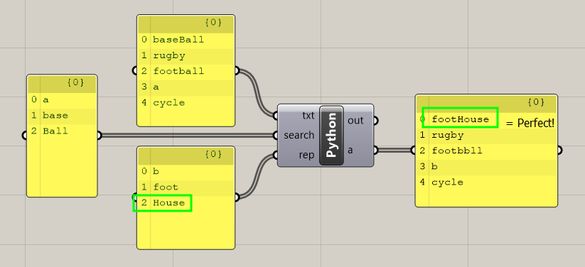

Noticed it almost goes correctly: See example below is perfect!

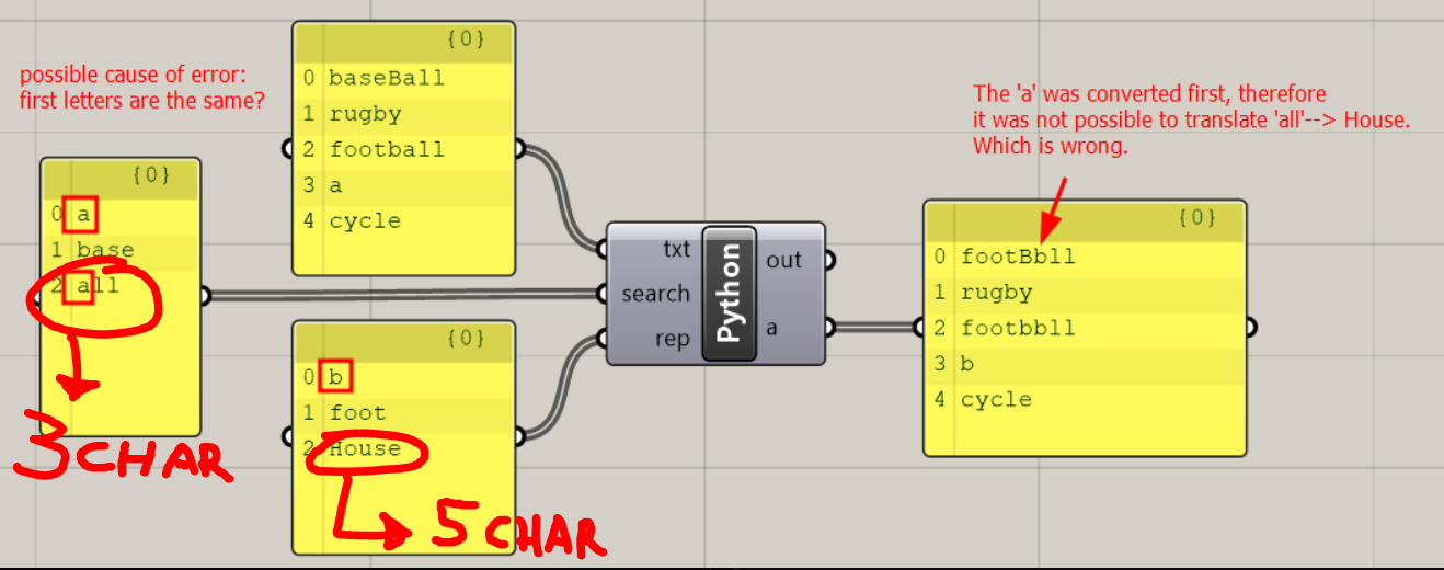

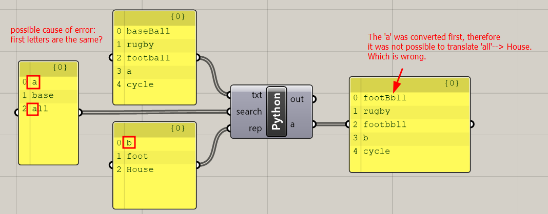

However, when the first Letter is the same as a ‘search’ text above it goes wrong, see below..
Wanted logic:
all → has the most characters so it should be translated first.
Hereafter the search key with second most characters has to be translated etc..
Any suggestion?
Just in my mind: the ‘search’ list has first to be automatically ordered so the order of translation is already correct.
Many thanks again!
