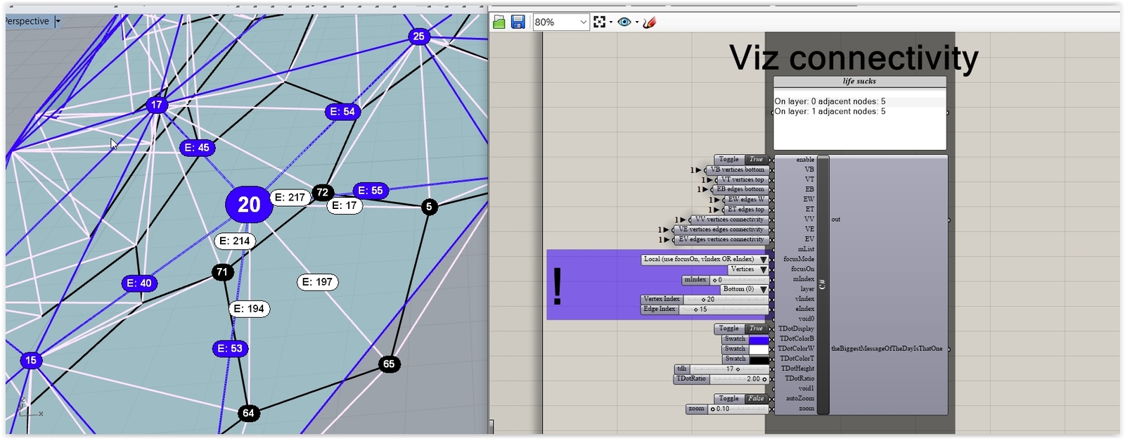

Note: a viz C# (I.e. see what we have on a per node basis) is critical since later on we need to check the angles and spot areas where clash situations happen.

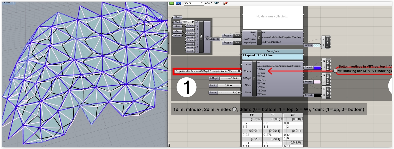

With the connectivity trees I also have a (essential it is)question:
  1. dimension is the mesh
  2. dimension is the vertex(until here no questions)
  3. dimension: how can a vertex be part of bottom, top or w? I thought it’s the same vertex.How to detemine which int the path gets at this dimension(which Vertex gets w?)
  4. the same as 3.
Probably I completly misunderstand that trees.
I would have done:
1.dimension mesh
2.vertex index

In fact managing nested collections via GH DataTrees is not a good thing since the C# core (the structure) would be associated to that internal to GH structure.
I.e a bad thing because the goal is to use R/GH as a rather small part in a big arsenal of BIM aps (main and verticals) … meaning that the code must be as GH neutral as possible: calling R geometry Methods is one thing (meaning that the code is portable (kinda) to other aps) … but what matters here is the management of the collections.
Anyway I’ll prepare an entry level take on these 5 Lists/Trees matter (minus internal tricky stuff). All that if the laptop works and if there’s no wind and if the social Dist thingy is the correct one (I doubt).

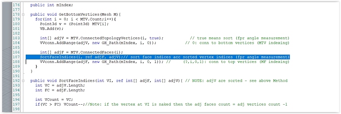

First you should use as many public stuff as possible (avoid locomotive long Method calls - we use that kind of approach in recursion as well):
Then use mini Methods to address each task separately:

    for (int i = 0; i < MTV.Count; i++)
      vB.Add(MTV[i]);
      int[] adjV = MTV.ConnectedTopologyVertices(i, true);
      vVConn.AddRange(adjV, new GH_Path(mIndex, i, 0));
      int[] adjF = MTV.ConnectedFaces(i);
      sortFaceIndices(ref adjV, adjF);
      vVConn.AddRange(adjF, new GH_Path(mIndex, i, 0, 1));
