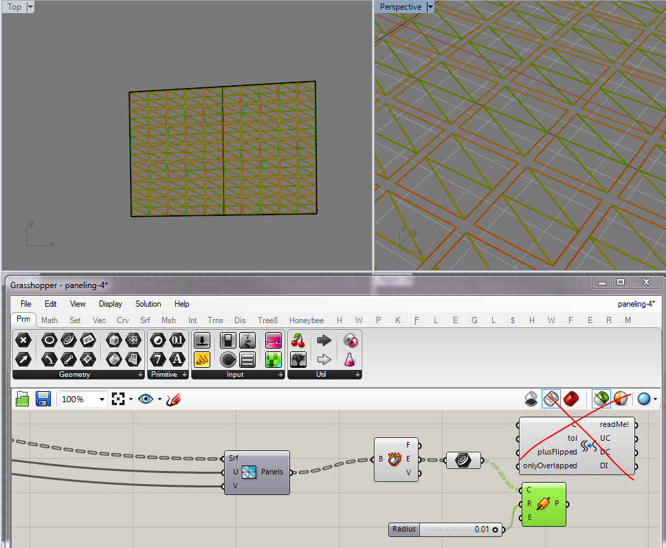

how can I remove one of each coincident edges from DeBrep ? for example, when I bake the curves into a pipe I get two overlapping pipes
ps. remove duplicate curve seems not working

You can use removeDuplicateLines from Kangaroo, or you can use the native CullDuplicates component.
P Pec.gh (21.6 KB)
Thanks @ Mahdiyar!
It’s because you are DeBrepping each panel. I believe if you flatten and join the panels to make a polysurface Brep, then DeBrep will give you single edges.
thanks @Michael_Pryor
this work as well and can be quite handy too
