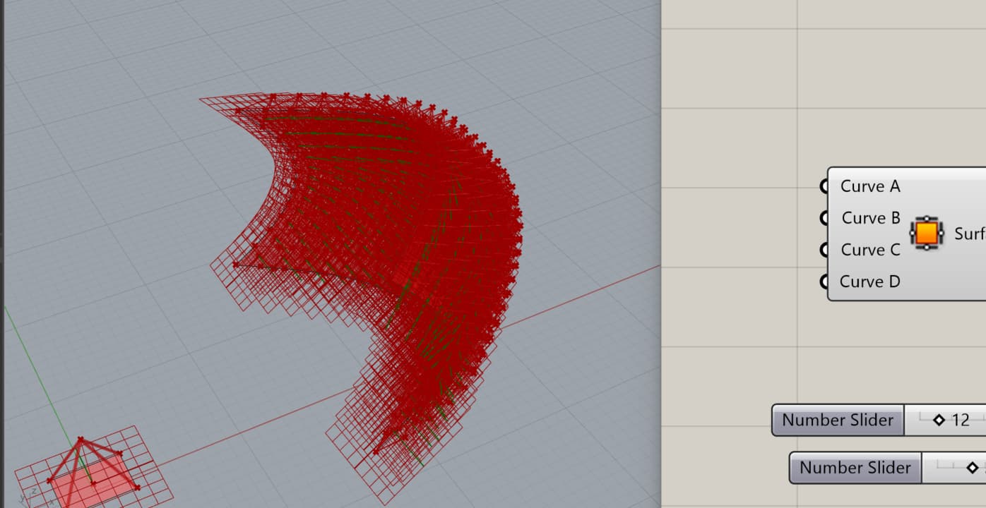

hi, how can i get rid of this red geometry plans from rhino… i cant see my structure with them on it
Turn off the component and attach Surface
set the size to 0
thank you :slight_smile:
to answer more precise, depending on what you want
  • use aforementioned solution, if you want to turn off all planes automatically
  • rightclick the battery and uncheck Preview, if you only want to turn of those
planes…
