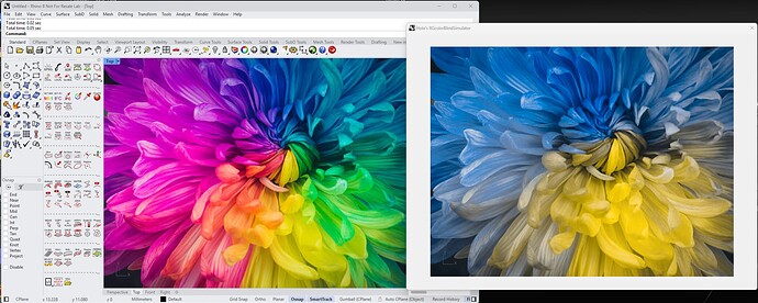

11 years… and I picked this up again since Rhino 8 can use the powerful OpenCV image tool.
So now we are down to 0.05 seconds to calculate this:
(With the old bitmap.GetPixel(x,y) and SetPixel it would have taken 30 seconds or more)
On a full screen it takes 0.09 seconds, so that’s awesome.
This laid dormant for so many years since I didn’t adapt it to ETO, but now I have rewritten the entire thing so the image is shown instantly too.
I’ll push this out as a plugin on YAK soon. I really think every designer should have the ability to evaluate what the world looks like for everybody.
(Nerdy edit: I just compared the old with the new and the old took 42 seconds and the new took 0.02 seconds, that’s a whoppin 2100 x speed difference… or 0.5% of the old time. Now that’s progress…)
