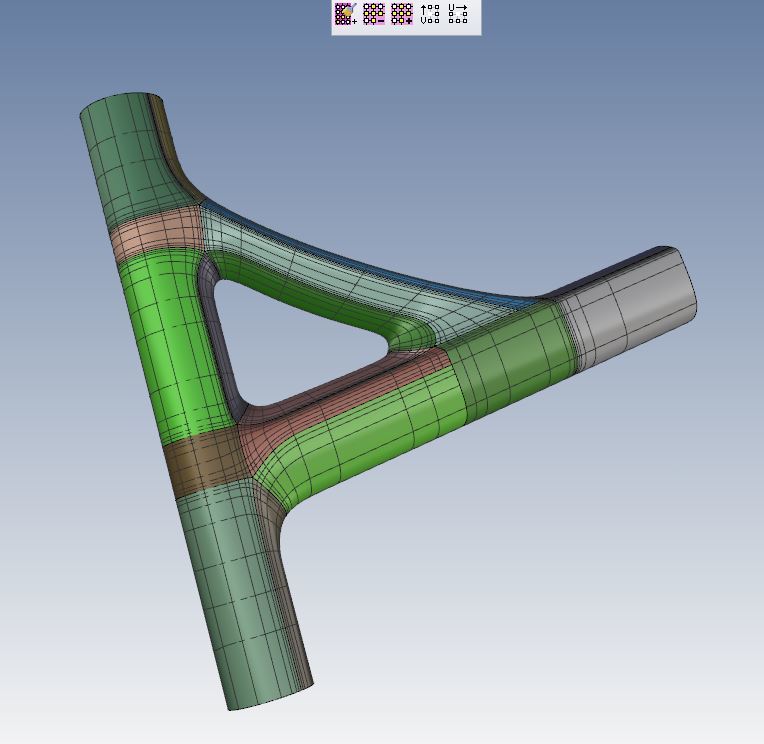

A request, this may already be possible, but I’m not aware of how to do it. Is there a way to have a display setting that shows the individual patches with random colors? This is very useful if you are working on the patch layout. It can quickly visualize what your edge flow is and what the shape of the patches is.
This feature is found is some other surfacing software. I grabbed an image for the web to illustrate it. This would just be an analysis setting that you turn on and off, think of it as an extension of the Zebra and Curvature tools.

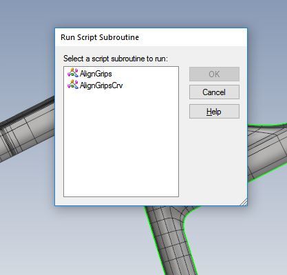

Thanks for the quick response and the help. However, I may need more handholding than this since I can’t get it to work.
I added the rvb file to Rhino and if I run the “Loadscript” command I can load it. When I run the "runscript command it does not show up. I can see AlignGrips and AlignGripsCrv
I have also tried typing RandomColor in the command line but it doesn’t recognize the command. I’m new to scripting, so have no idea what I’m supposed to do. What am I doing wrong?

Hi Mark - I think I set that script up so that you can just drag and drop the rvb file onto Rhino and the alias will then just work. I’ll verify and get back to you, it would not be the first time I goofed…
I did goof - the script is incorrectly named - sorry about that- hang on a sec…
RandomizeObjectColors.rvb (882 Bytes)
@Mark_Landsaat Delete that one and drag and drop this one - the alias will be the same - RandomColor.

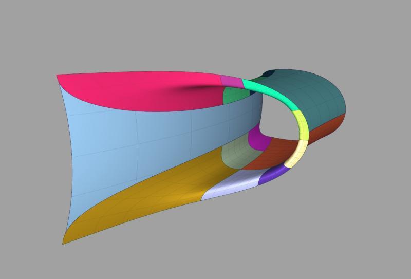

@pascal, don’t you remember TestRandColor (Warning: includes funny disco effect :slight_smile: on view manipulation and works in every display mode. Run it again to turn it off).
c.
Hi Clement - I do… but it seems too um, jazzy, to be of real use for more than about 0.5 seconds - we don’t want users checking themselves into the local asylums.
But, yeah, @Mark_Landsaat - try testRandColor, if you can stand it it may work for you.
Hey, use it all day long and it makes Rhino great again :tired_face:
Pun aside, a display mode which colors sub-surfaces without exploding might be handy.
c.

This worked, thanks for helping me out with this. I did try the TestRandColor which is fine if you don’t manipulate the view. I think I will stick with the script for RandomColor. This does what I want it do. Thanks for the help.
I just want to chime in and say that TestRandColor worked great since it was easy to toggle on and off, and even worked in both shaded and rendered mode.
However, there’s no predictive typing hints for this command, so unless you stumble on it in the forums here, I believe it’s impossible to find out for new users, so I’m hoping a proper mode with an icon will be added for it some day!
