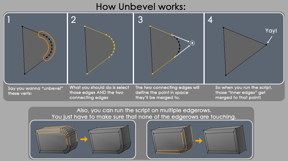

@pascal - just an idea to script something like an Unfillet-Script when there is an option to detect fillets via the perfect curvature? I know there was a script for Modo for unbevel…
Here is the Modo way

I see Modo as an example above, and I know that mesh editing is quite different from nurbs editing, but there’s a recent example for Blender as well:
It’s got amazing options for detecting even variable width fillets and options for face results after the unbevel operation.

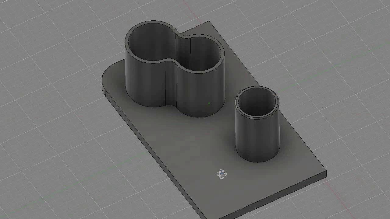

Here’s Fusion 360 doing it with imported STEP geometry…
I did not know that. I also replaced my example above with a more advanced one (a lofted surface) and actually Fusion 360 managed to delete it as well with no issue… damn, Rhino is really behind in this area, even more than I thought.
