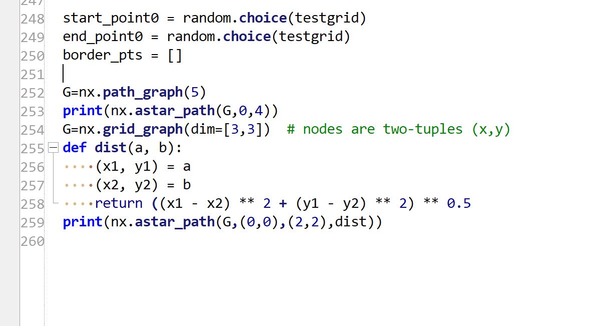

This is what I have so far:
I do not know how to insert my list of points (border_pts), end_point and start_point0 into the script underneath that contains just 2D-tuples. border_pts is a 3D grid.
Maybe someone can help me to solve that.
Still not woking correctly
