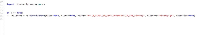

Trying to open a file with a button but don’t really understand which way wrote the information into the command line.
here is my python work :
open-doc-command.gh (2.4 KB)
I find myself that I must wrote a double \ → \ but still can’t directly acces to the file…
This just returns a string giving the path to the file - it does not open it. You could maybe use rs.Command() afterwards to script the -_Open command to load the file …?
https://developer.rhino3d.com/api/RhinoScriptSyntax/#userinterface-OpenFileName
Put a r in front of the string and then no need for double backsplashes. r stands for raw string in Python.
r’your string with single backslash separators’

If you’re trying to open a Grasshopper file from a GHPython component (the methods suggested in this thread are for opening Rhino files), have a look at this old thread:
Additionally, here’s how to access the solution suggested by David in that same thread:
sorry I didn’t understand it really well the first time I read it !
So I decided to wrote it that way :
this is my result :
if x == True :
path = ‘“H:\0_ACAD\10_DEVELOPPEMENT\LM_ARB_Firefly\Firefly.gh”’
rs.DocumentModified(False)
rs.Command(‘_-Open {} _Enter’.format(path))
