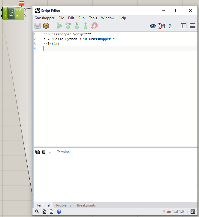

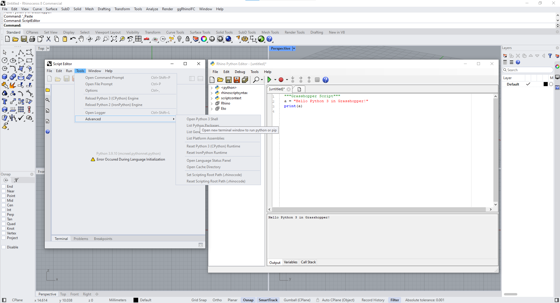

I am in the process of learning how to use the CSI API within grasshopper, one of the ways is using python, at the time of placing a python component and start testing I realized that I had restricted the modification of the file:
So I started to try a couple of things that I found in the forum, such as changing the folder where python is initialized, repairing the installation, reinstalling rhino (deleting the appdata and runtime folders), I even downloaded a test version on another computer, where I had no problem to use the python component and install libraries, so I checked that the problem is in the company’s computer, and I assume that most likely it is something related to the IT department has some configuration that prevents access to any resource that allows the installation specifically to python, I attach the log:

In case that is the case, could you help me to confirm that it is indeed that? to try to bring up the situation to the IT department and see if somehow they can allow it, and in case they do not approve it, is there any different way to be able to make the installation?
