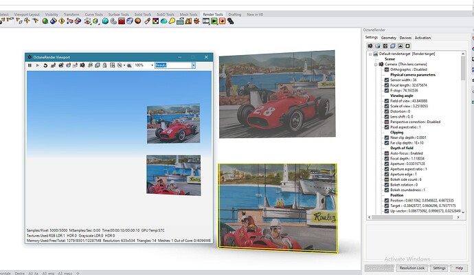

I’m using Rhino 8 SR6 8.6.24101 and I’m using Octane Render 2023.1.0.137. Previously, I was using Rhino 7 and this issue wasn’t present. The problem is that when I insert a texture into the Rhino preview, it looks fine, but when I launch Octane, the result is as you can see in the attached video. I’m also attaching the file for verification purposes.
I have already contacted Otoy and according to them, it is a UV issue in Rhino 8
How can this be resolved?

Well, I don’t have access to the full Octane Render but testing with the demo version suggests that Octane simply uses the texture coordinates that are on the render mesh. It works in most cases for Rhino 7 depending on the object - but it’s not reliable.

If I load the R7.3dm file at the top of this thread into Rhino7, and render out the UV Coords, I get
…which is correct.
If I load the same file into Rhino8, I get the following - where you can see the bottom mesh object has incorrect UV’s.
I don’t understand why Rhino 7 and 8 are treating this file differently.
As a test, I added that image map to a Rhino material and assigned it to the mesh. All looked good with the mapping channel set to 1.
However, mapping channel 2 actually matches the Octane plugin UV’s.
So it looks like mesh.TextureCoordinates is returning UV map 2, instead of UV map 1?

The texturing area in Rhino has evolved over the years in a slightly uncontrollable manner. One of the biggest issues we are dealing with is the reckless usage of the ON_Mesh::m_T array. For Rhino 8 we decided to take a step towards deprecating it. We expected things to break and thought we could fix them or help 3rd parties fix them.
And in the case of Octane the fix would be setting up cached texture coordinates and using them. And that fix would have to be on Octane side.
