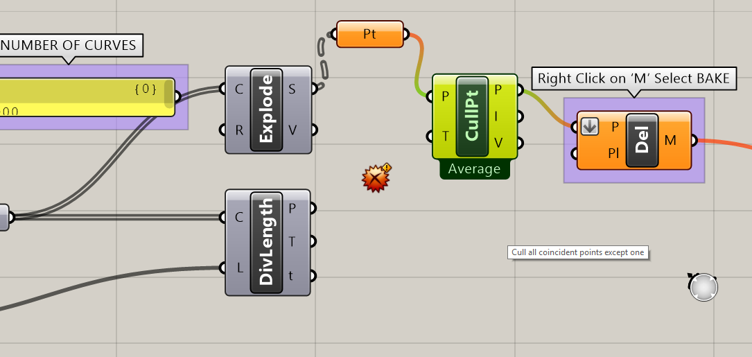

Hi everyone; i have this big problem with this mesh in Grasshopper, which is a ground model created from several contour lines. I can’t bake it bacause it’s an invalid mesh, but I don’t know why. Can someone help me??
LUCA.gh (12.0 KB)
LUCA.gh (12.0 KB)
Hi Davide
Your pt parameter has duplicate points
what I have to do? If I delete it the mesh disappears.
Delete duplicate points.,such as: Cull Duplicates
Your output geometries from Explode’s “s” output are not points. They are curve segments from your curves. Use “v”(Vertices) output instead.
And make sure to “Flatten” your Point(Pt)parameter.
Thank you, now it works
