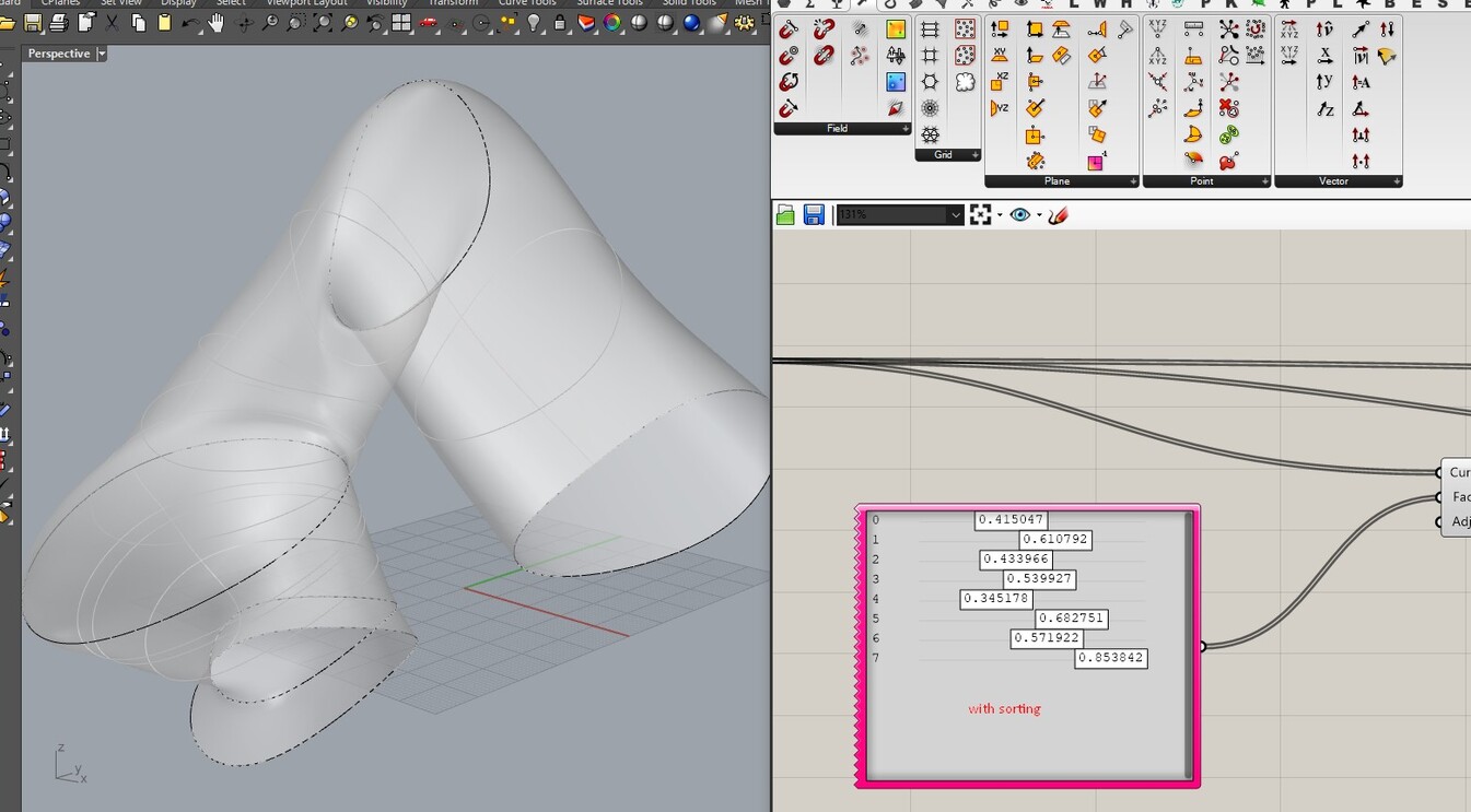

Yes, PF tween works wery well, but when i use Gene Pool it’s require that each number must be no more than the following, which not so convenient to me.
Please explain further, there is no issue using gene pool with this method that I can see.
I mean if i use PF tween with Gene Pool its steel require sorting if the sliders are located in different positions. It’s not a big problem but when i work with a huge ammoun of tweens this is little annoying to place each slider in a right position.
Without sorting:
With sorting:
Hi, I think you missed the sort component in my definition, this will take care of sorting for you.
