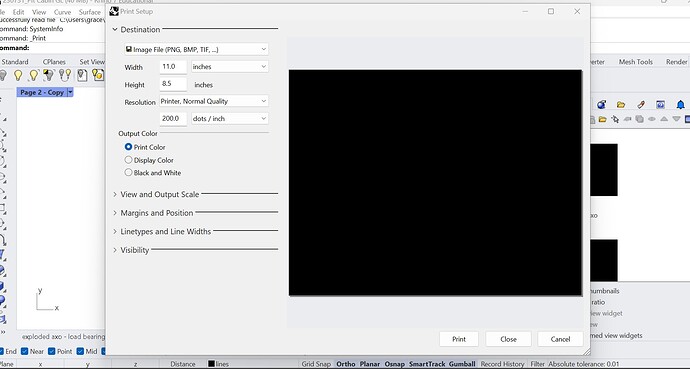

Print pdf keeps showing black screen/blank
I already tried reinstalling rhino 7, updating graphics cards, and switching around the graphics card on Rhino. Nothing worked

ATTENTION:
No graphics device is being used. Either an error occurred on startup, or certain devices have been disabled.
See below for any possible configuration changes that may help resolve this issue.

Rhino’s black screen is a symptom of the screwed up graphics configuration on your computer.
Did you see this in the SystemInfo?:
Assuming your monitors are connected correctly, this should help get Windows sorted:
Any luck?
