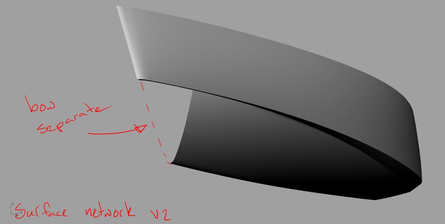

I’m trying to model a power boat hull, I’ve had a few goes at it but unable to get a desired result.

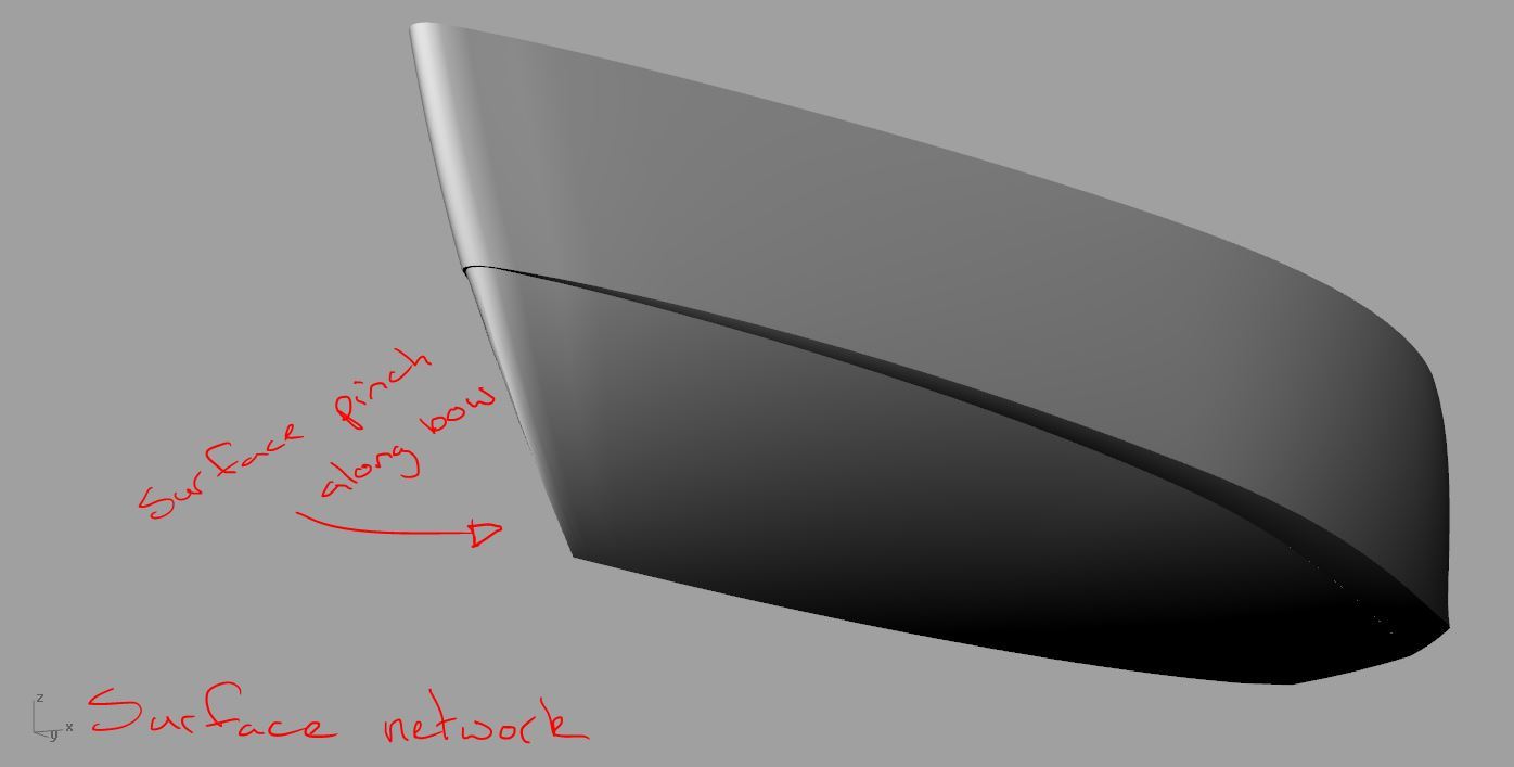

The bow cone is causing the most problems, I see a lot of boat models online simply join the bow to a sharp point, I would ideally like to add a round to the bow / knuckle. ( please see screenshots below)

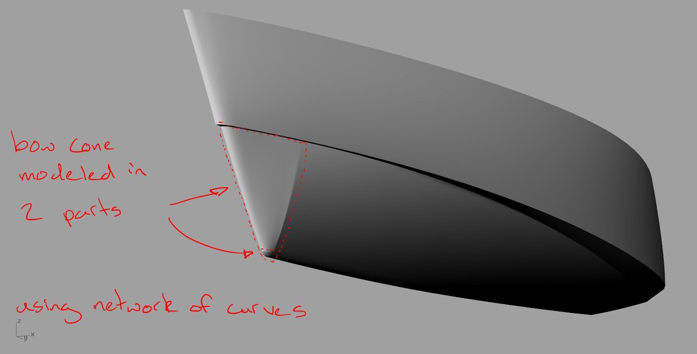

I’ve tried a number of ways, mostly “surface from network of curves” the surfaces end up being very dense, so I’m thinking there must be a better way. I’ve also tried to split up the hull so I do the bow cone by itself but end up with ugly joins.
If someone could give me some tips on a better way to approach this model it would be greatly appreciated

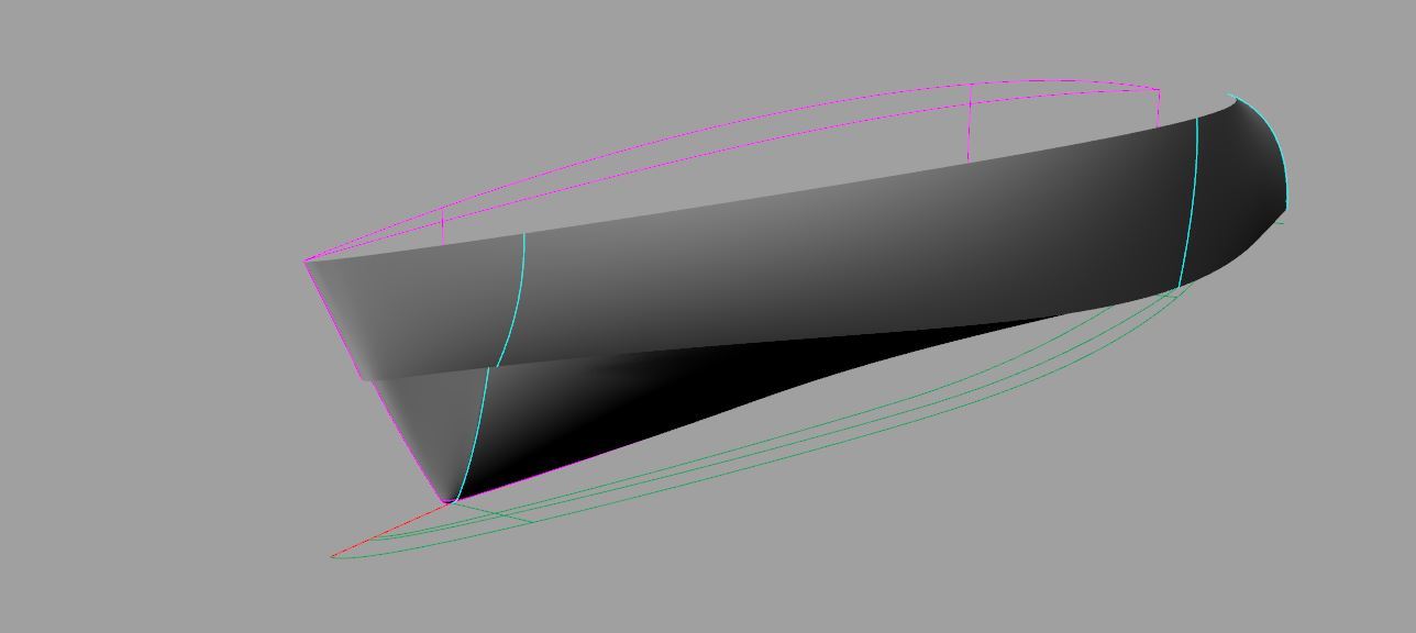

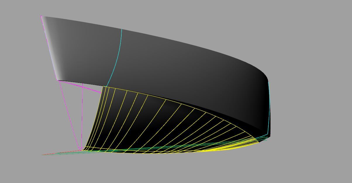

Thanks for your reply, I tried the 2 rail sweep on the bottom surface. Looks pretty good. I’m new to Rhino so I’ve had a go at “matching”. Does not work really. Maybe I’m doing it wrong.
sweep results below
Often times the best way to do those bottom surfaces is to extend the edges beyond the center line then get the knuckle shape by trimming that surface with the XY plane. Turn history on before trimming (or just do an intersection) and you can interactively adjust the shape by tweaking the edge curves.
It’s possible to get a much more natural surface that is not contorted by trying to resolve the corner of the UV net into the shape you want.

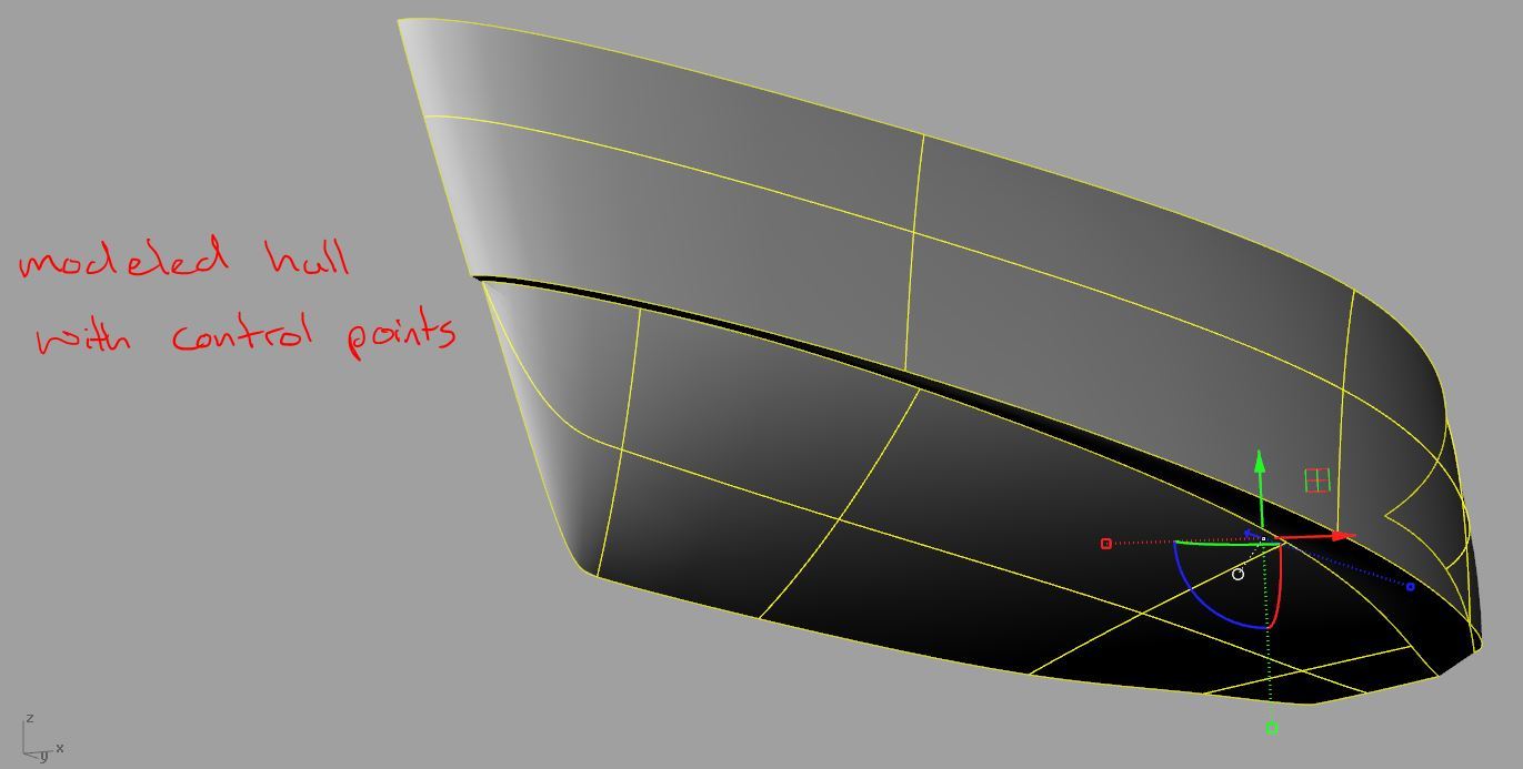

Is this what you’re aiming for?
Hey guys, Your comments have all been really helpful. Stratosfear, that looks great. So along the bottom you have split into 3 surfaces using 2 rail seeps ay?
You can use 2 rail sweep. I prefer using surface blend and rebuild to match the surface degree and point count to the secondary surfaces. Then I run dup edge curve and pull back to trim away the corner of the main hull surface. Then match the blend surface to it.
