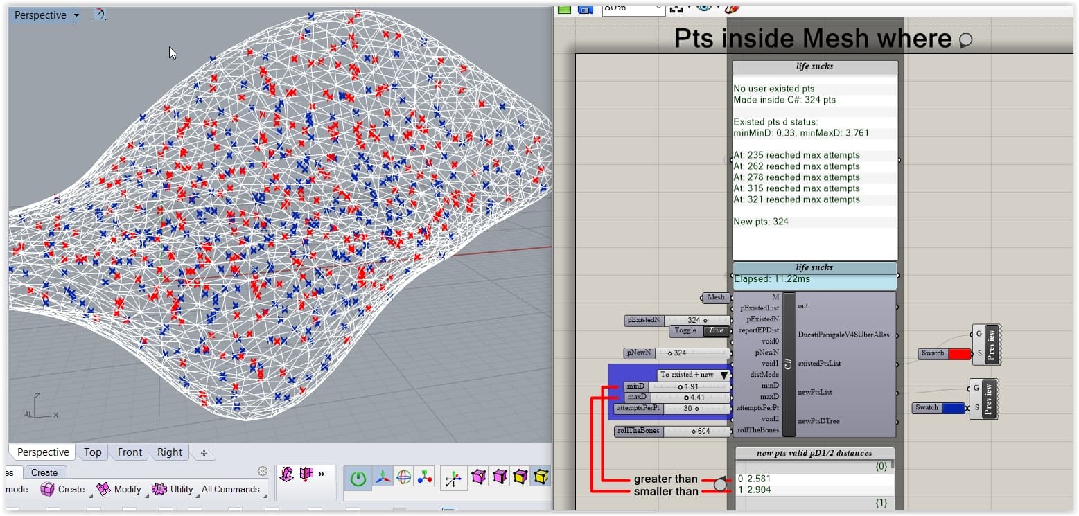

Well … I have LOT’S of similar things (for rnd trusses, rnd spaces, rnd dogs, rnd cats etc etc). So I did a few mods for a C# that does that … and guess what? a Point3dList based search (Note: for each candidate (rnd) pt we test only 2 pts: the prox (where d should be > min) and the next prox (where d should be < max)) is faster than a RTree (because we sample all existed pts where d < max and then we test each one if d > min). Small differences - obviously - but every millisecond matters.

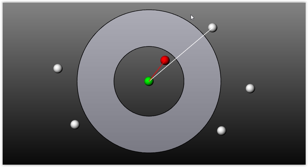

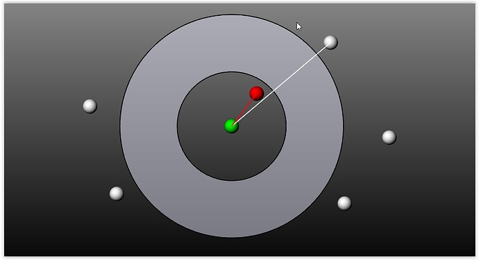

Well … the approach used has as follows:
I.e. foreach random candidate Pt (inside the Mesh) get the prox and the next prox. If dist to prox (red) >= min and dist to next prox (white) <= max … that’s a valid Pt.
Is this what you are after? If no … what EXACTLY dist condition are you looking for?
Sorry … but I can’t understand an iota - opposite to what? Maybe with regard the if clause used : proxDist >= min && nextProxDist <= max. Meaning that you want: proxDist < min && nextProxDist > max ??? (this yields a disc containing the prox and the nextProx pts).

PS: currently for, say, ~400 start up pts and ~400 new pts the Elapsed is circa 10 ms (more or less OK) using my classic crap I5 (I always use the slowest CPU around when writing new code). But if you have in mind 1+B pts … well … that requires a different strategy.
