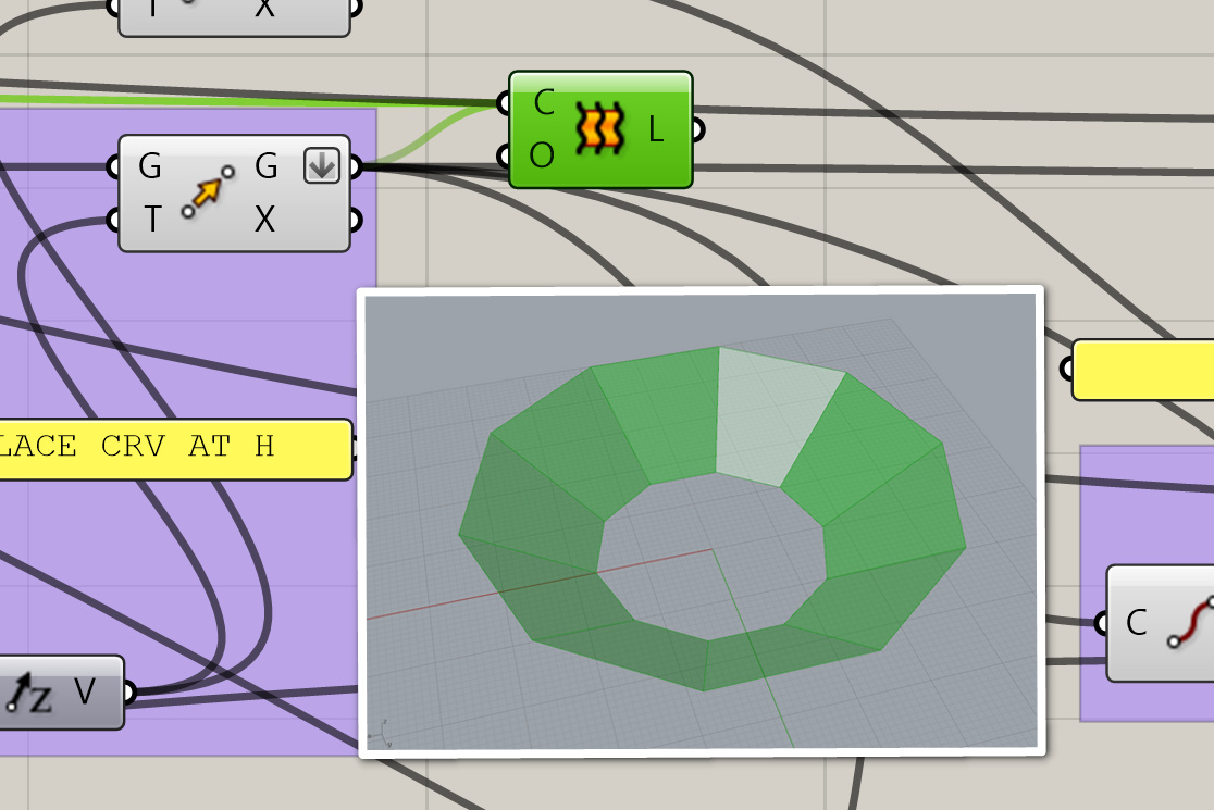

I want to make a circular-like auditorium, where I control the angle of the seating and the depth from the first line as well as the number of sides of the polygonal basis.
My definition only works for 6 and 10 sides, any other number bugs.
I tried to fix it by resetting the section curve, but I still have the bug.
Can anyone help me with that?

2 way to cope with the problem
  1. Scale the upper polygon instead of offset (Offset add control points. Offset loose open the cure)
  2. Use loft with the 2 polylines
Thanks, with loft the problem is solved.

If you want to use offset then just simplify the result to remove the extra control points. Then it works fine.

thanx, simplify does the trick !
