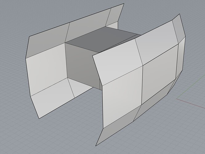

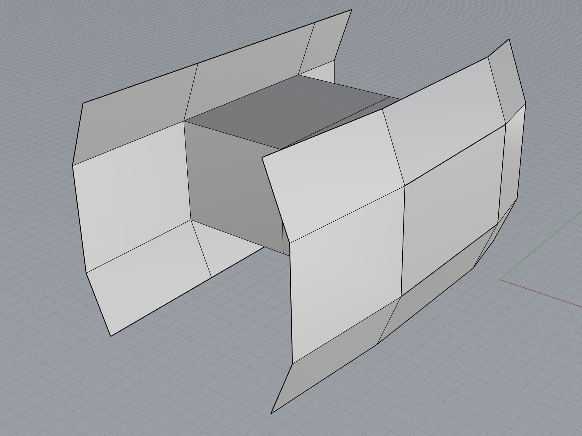

If we had Subd’s which we could match a vehicle’s interior panels–with an optimized exterior. Even if we had even one level of hierarchy, SubD’s would be much more useful.
In this example, the Subd hull, is supposed to represent a car vehicle side in Box Mode, (and not Lord Varder’s ride.)
This is the surface I might want in smooth mode:
This shows the differences with soft edges:
This is the difference if hard edges were used.
Granted, this would be somewhat unconventional implementation of SubD, but the smoothing rule would be the same, so it is a natural extension.
So, the GUI might work like this. You pick the superordinate object, and the subordinate, by virtue of being coincident vertices follows the superordinate.
And then, this result is a step in right direction:
In other words, I do not want the vehicle interior panels to interfere with the exterior.
One of the only problems with NURBS is I cannot reproportion them.
One of the only problems with SubD is: If I subdivide the mesh, I would not be able to retain the outer shape–without making one that that is no longer ruled by the fewest nodes, which gives me the smoothest shape. If I subdivide them mesh–it will also become uneditable.
A node-based solution would also work, by specifying which nodes are subordinate.
A solution whereas SubD faces could be hidden from the rendering solution, would work to some degree, but that would increase the memory usage, and it would not quite solve not-mangling-door-panel problem.

I am trying to create an opening without affecting the curvature of the outer panel. Sorry, about my quickie example.
I’ve been working on an aerodynamic vehicle body using Rhino SubD, having done eleven generations of OpenFoam study, and work on aesthetics, which was needed.
As similar technique as NURB’s, there are very few control nodes in the shell, as few as possible, which allows the shape to optimized–without extraneous intermediate nodes which would only degrade the the shape.

I want to be able to cut door and window openings and into the vehicle body–without affecting the larger sense of its shape.
I also like the technique of matching the dash to the hoodline, which is not always done.
I have a sense of how to make the body out of NURB’s, but once they are trimmed and joined, that hull could not be easily re-proportioned, as to say, make the window opening a bit smaller. I would need to maintain several stages of body surfaces and primitives, also.
Presently, it’s in SubD, if I add nodes to add window openings, the face splits they would cause would make it difficult to keep the exterior shape. Rhino is very forgiving by adding and maintaining hidden splits, but for a big hole, more car body surface nodes would need to be added, and because of that, changing the the surface would be less accurate. Smoothing might then help, but presently, we cannot smooth to a guide spline, which I have been doing manually ; )
[ Basically, weather I have a SubD or NURB surface/curve with say 5 nodes, I use a 3-node curve as a guide to attempt to fair the more complicated surface/curve the same as the the more simple one.]
The problem for either SubD or NURB is: once cut, the more complex resultant object cannot be re-proportioned as well as a lesser node variety.

1.) The ability to hide SubD faces, so they can be part of the shape solution, such as NURB trims retain the original shape.
2.) The ability to intersect SubD’s using a hierarchy, and let us go back to the original shape. This would also be handy for NURBs, too. For this purpose, the thing is that somehow, the later subtractions cannot affect the original shape.
[I usually keep an Home-Depot orange Tool layer just for tools, but I also keep layers of each boolean-step. Managing this would be more fun, with just a right-click menu. I like the way 2d programs make compound objects. The metaphor of Rhino’s multiple undo would be good thing to start from, but let us do booleans like this, too.]
Using another metaphor, we would be making T-SubD’s.
