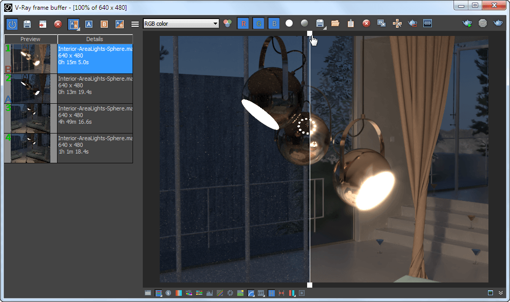

  2. Better history/recent renderings (with thumbnails!) are needed to better navigate between many renderings and easily compare them.
  3. Something similar to moving bar between A/B render as in V-ray would be handy to have.
(see history gallery and A/B vertical bar)

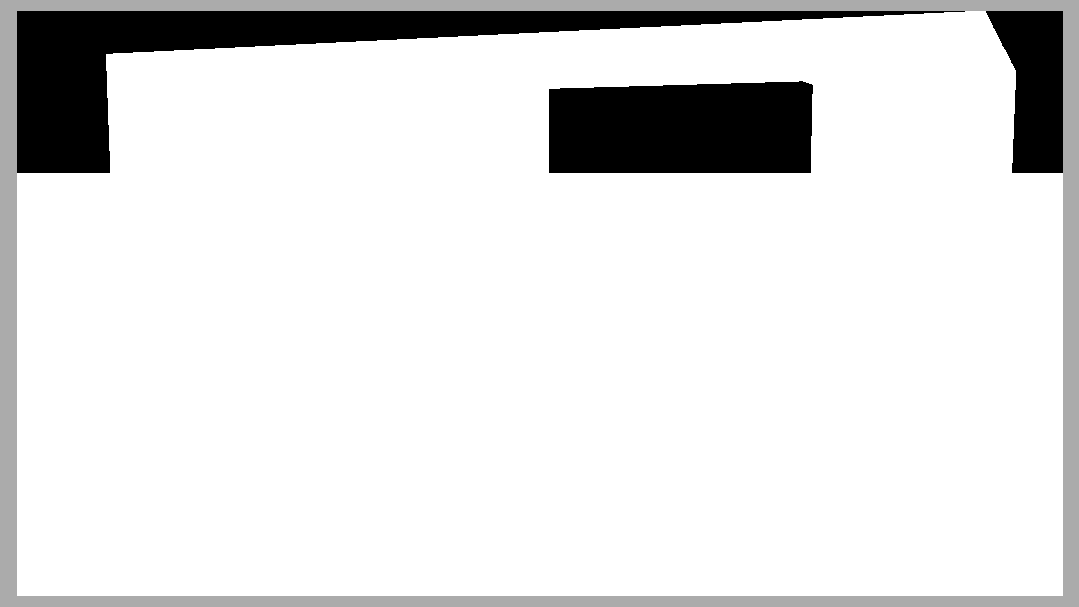

  5. How to set distance channel?

I don’t have V-Ray right now. Please check this video around 0:48

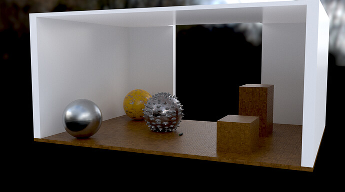

Mine doesn’t :frowning: Camera is set around 10m from the spiky sphere, room is 6m wide. No strange units of the scene.

What is your model unit setting?
edit: actually, try turning on the ground plane and see if you get better depth map.
Centimeters. Ground plane was turned on in show shadow only mode, changing it to normal doesn’t seem to help. I would upload this testing scene but for some reason it weights 400 MB…
