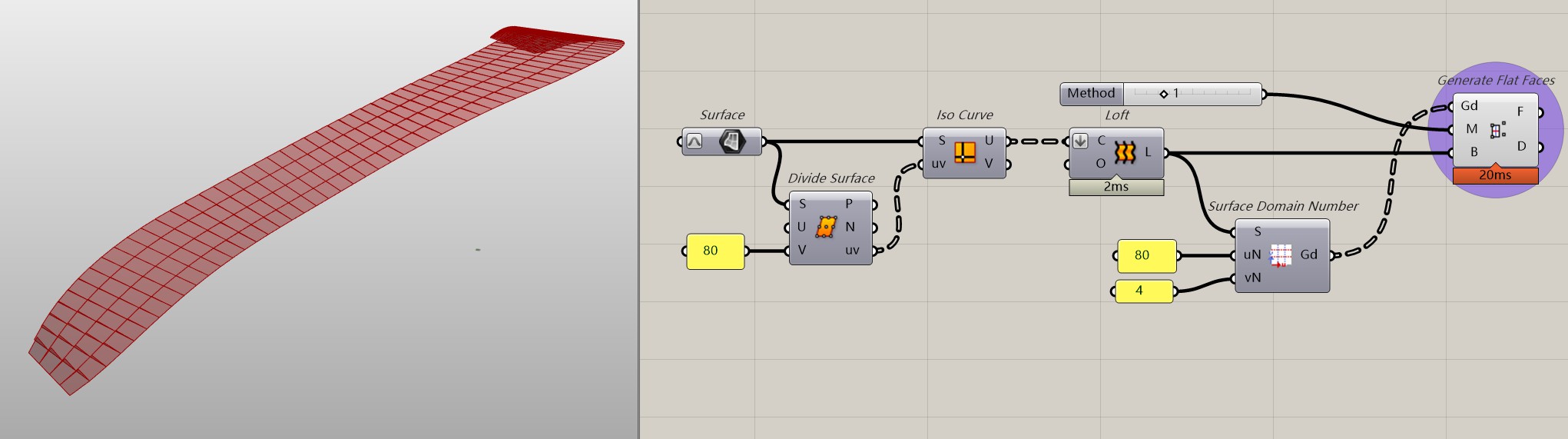

Please give it a try with PanelingTools, and fyi.
https://www.food4rhino.com/en/app/panelingtools-rhino-and-grasshopper
GenerateFlatFaces.gh (67.1 KB)

I noticed that you require all panels to be flat, while the base surface you provide is a curved surface with curvature. For this specific case, PanelingTools is an excellent solution.
BTW, You can modify the input paramter M in the Generate Flat Faces to choose which point to leave ‘suspend’(the panel will pass entirely through three of the points, effectively ‘abandoning’ the fourth point)

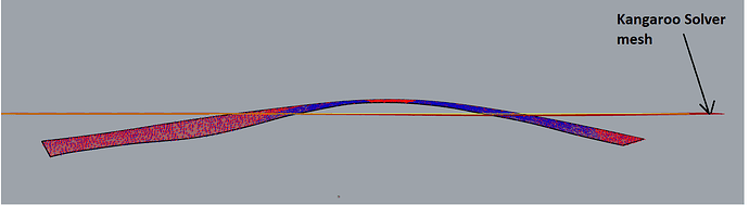

Hello @DanielPiker
I am using your principal curvatures definition to create the initial topology mesh:
I set this topology mesh to your isothermic quads Kangaroo definition.
For some reason the final Kangaroo Solver mesh remains in a single plane. It does not follow the shape of the curved input surface:
Would you be able to tell me what am I doing wrong in the attached isothermic quads definition?
I would be very grateful for your help in this difficult task. I can’t thank you enough for this.

Hello @DanielPiker
I am using isothermic quads Kangaroo definition to try panelizing attached curved surface.
Tried experimenting with numerical input values you provided in this file.
I do not understand why the final Kangaroo solver mesh remains in XY plane.
How should I modify your inputs so that the final mesh follows the curved surface?
I would be very grateful if you could assist me with the inputs.
Thank you in advance for your support.
