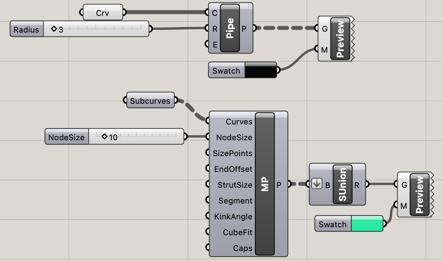

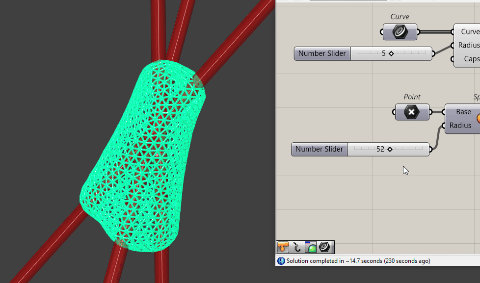

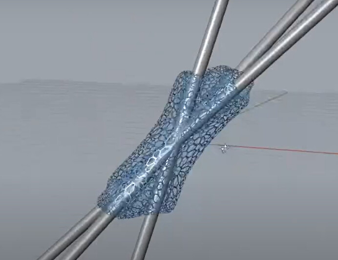

Parametric house has done this cool parametric joinery that I’ve seen others doing on blender. I don’t want to spend $90 to see the definition but I’m also struggling to figure it out on my own.
https://parametrichouse.com/parametric/parametric-joint-2/
I don’t care about the surfacing but want to be able to make a blobby parametric joint between a variety of geometries.
Does anyone have any tips?

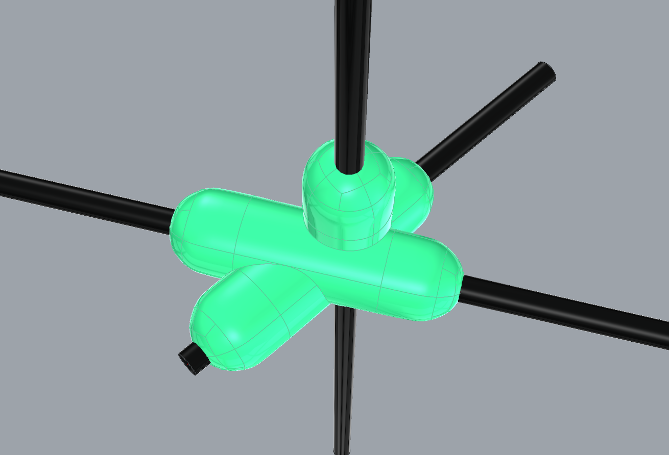

You could start using Mulitpipe.
Parametric Joints_EW.gh (14.4 KB)

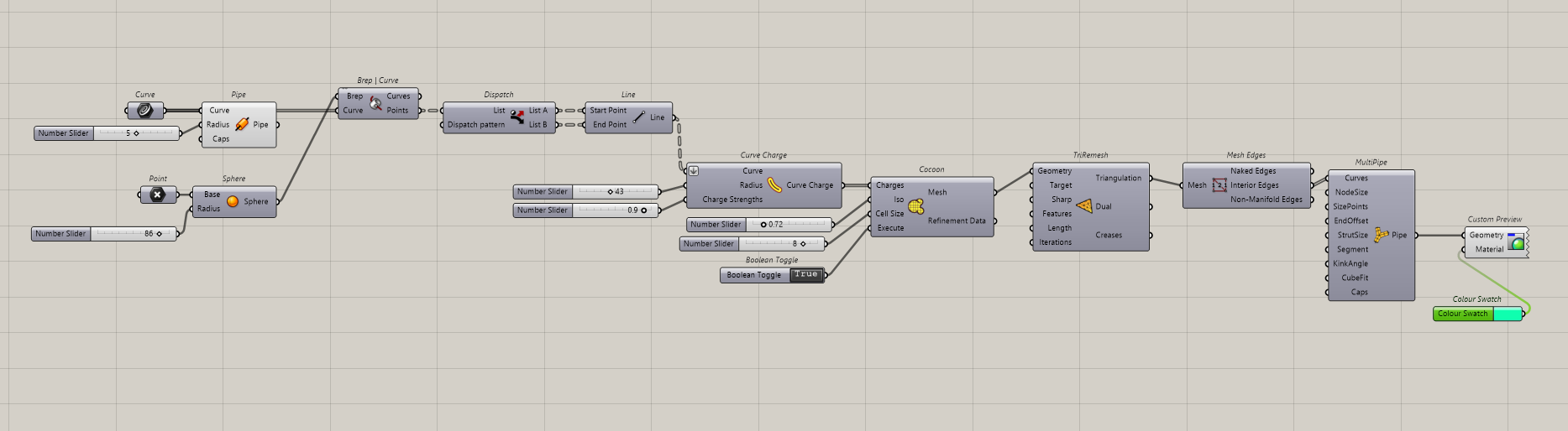

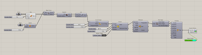

You’ll just need to boolean difference the pipes from the shape.
meta.gh (11.5 KB)
